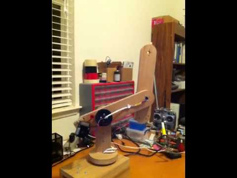

    A little more progress on the physical build. I have to add another motor controller and cooling, and then the programming begins.
    [video=youtube_share;PUprJMROBSM]
    edited 2013-03-21 05:52
    Jason, I'm drooling. A robot arm that size will be really capable.
    edited 2013-03-21 08:46
    I'll be happy if it's capable of lifting a light tool. :) It's much heavier than I expected, so I may need to rebuild the shoulder to hold two steppers, like the ST robotics one, or at least move the existing steppers back further to balance the weight better. I had to turn up the current to the motor because it was skipping.
    The distance between the shoulder and wrist pivots is 14". My single 88-oz-in stepper will put out 1.75lbs of torque at 14" with the gear reduction I have. The arm already weighs quite a bit, but the weight is slightly counterbalanced, and not that far away, so it may just be okj. Once I put the wrist on I may hit the tipping point, but this is good enough to get started on the programming. :) I have a bunch of pics of the physical build I'll post when I get some time.

    I've contemplated moving the motor to drive the shoulder onto the base. The way it's built, I could simply move the stepper to the opposite side of the joint - The stepper would sit on the side of the piece that connects the waist to the shoulder, and drive the shoulder from there. I could then move the elbow motor onto the upper arm in the same way. It'd help keep the amount of weight it has to support down, but I'd have to make sure the piece extending from the waist to shoulder was sturdy enough not to have a brace.
    This picture shows where the shoulder stepper is mounted now. If I moved it further away from the pivot I could get more counter-balance action from it. I also want to try just adding some weight. The pulley is currently bolted to the shoulder, so it stays fixed as the arm moves around it. I could reverse it so the pulley was on the other side, and rotated with the arm.
    This picture shows the waist / shoulder. The brace runs up the side, and I'd have to remove that to mount the stepper there.
    These two show how the pivots are done. I use large diameter ball bearings seated into both sides of the wood.
    Then I have these "half spools" with thrust bearings that go on either side. You bolt an arm to one of the spool halves, bolt a pulley to the other one, then bolt the two halves together. There's a 1/2" hole in the middle to run wiring through so I don't have to worry about it getting tangled.
    I've also been contemplating cutting a bunch of holes in the wood to reduce weight. Probably the next iteration I do will have some pockets cut into the wood to remove material and lower the weight, but the stepper motors are the bulk of it. Moving them further back or adding counterweight will likely make the most difference. I want the thing to be relatively beefy (IE sturdy), but cheap to reproduce.

    Finally here's the gcode seen in the video:
    G28
    M11
    G92 X0 Y75 Z40 A-90.00
    G1 X-55
    G1 Z0
    M10
    G1 Z20
    G1 Y140
    G92 C-27
    G1 Z0
    M11
    G1 Z20
    G92 C0
    G1 Y75
    G1 Z0
    M10
    G1 Z20
    G1 Y135
    G92 C-27
    G1 Z0
    M11
    G1 Z20
    G92 C0
    G1 Y75
    G1 Z0
    M10
    G1 Z20
    G1 X0
    G1 Y140
    G92 C-50
    G1 Z0
    M11
    G1 Z20
    G92 C0
    G1 Y75
    G1 X-55
    G1 Z0
    M10
    G1 Z20
    G1 X0
    G1 Y135
    G92 C-50
    G1 Z0
    M11
    G1 Z20
    G92 C0
    G1 Y75
    G1 X-55
    G1 Z0
    M10
    G1 Z20
    G1 X55
    G1 Y140
    G92 C-70
    G1 Z0
    M11
    G1 Z20
    G92 C0
    G1 Y75
    G1 X-55
    G1 Z0
    M10
    G1 Z20
    G1 X55
    G1 Y140
    G92 C-70
    G1 Z0
    M11
    G1 Z30
    G92 C0
    G1 Y75
    G1 X0
    And video:
