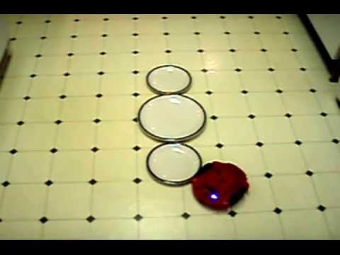

Based on a pseudo-challenge from John Board at http://forums.parallax.com/showthread.php?138125-Erco-s-Figure-Eight-Challenge&p=1093798&viewfull=1#post1093798 , here's my first pass at getting a Scribbler to to do an ellipse/oval. Best I can do at 4 am before vacation. I'll do better later. Can YOU do better? I'm calling out every roboticist here! My code posted after the video.
Here's my code for your consideration. It won't work in a stock Scribbler. This one is modified, different gearmotors wired to run in reverse. But you can see my thinking, or lack thereof. It runs the right outside wheel at max constant velocity while the left inner wheel ramps down and up twice. I think a BoeBot would do better on this course. Too bad I mounted a flamethrower on mine and gave it to Ken... :)

    An S2 (with its encoders and PhiPi's fine S2 object) could fake an oval with several "arc to" commands, changing radius 4 times. Heck, ttailspin or the Gatorbots could knock that out in a minute or less.
    Who'll do it first?

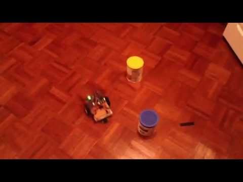

    My answer to the challenge.
    My code is not just for ellipses, it is a complete curve following system!

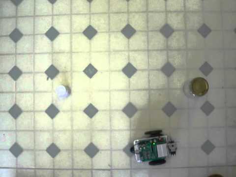

    Erco, you hit the nail on the head. One lap took a few minutes, 2 about an hour. I wanted more. Haha
    I'll pass on my time line for four laps. I really did get a little bit of other stuff done this weekend.
    It is propeller powered, no encoders. I believe you call it differential steering(?).
    There are three IR sensors on board, unused in this program.
    Well, they do change the indicator LEDs from green to red but have no impact on the drive motors.

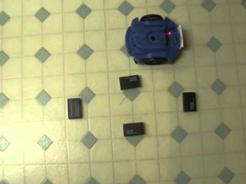

    Anyways, Here is a Scribbler2 in action around the Oval, or Soft Arch as it's called in my trade...
    Not the fastest or the coolest lap around the plates, but what can I say? I am still a bit fuzzy...:confused:
    Have fun on your vacation erco, and try not to go into BS2 withdrawals while you are Away From Keyboard...:thumb:
