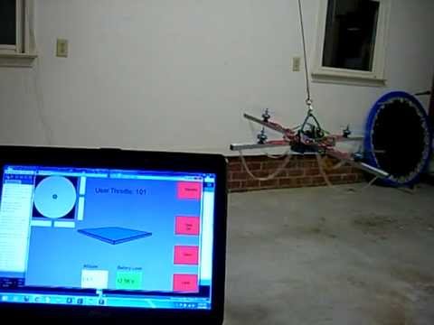

    Until you get use to the controls, tether it. You could setup a counter balance to include lift + pitch and roll.

    Lost orentation, reconfirm that 90 degree to the ground won't produce any lift. I came down bu recovered mostly before grounding, only lost 1 prop but did crack a main plate on the bottom. Before got 4 batteries worth of flight time in before. When learning to fly the heli I was really conservitve, wasn't much fun. With the Elev-8 having lots of fun and it really does attrack a lot of attention from kids and adults alike!!
