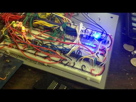

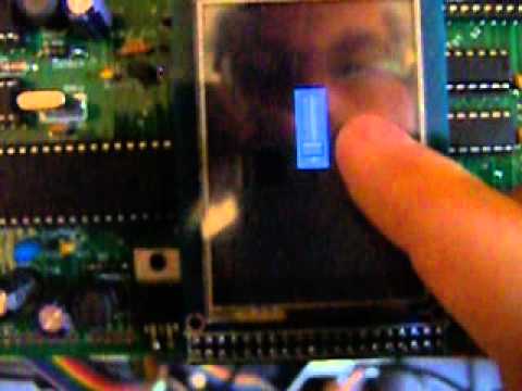

    So I spent a couple hours today putting things together, and I believe all I'm short of is the LCD cable and a few resistors. I will try using a `138 and a `174 for now. When I'm in Reno tomorrow, I will check Sandy's for a `237, anything else I should grab if they have it?
    The other thing I'm thinking about... @ the expo, I grabbed a few 8583 RTC's, and I thought one might come in handy. I also like the second 3232, although I won't be using that or the keyboard right now. I have a feeling the I2C breakout will be coming in VERY handy. Gotta run, just wanted to give an update.
    edited 2012-04-18 05:11
    This version sent off tonight (see below). There are three previous versions I have being made and on the way from China but they are all paths towards this board so may not end up being used. It probably is still not quite there but I think it is close enough. Same schematic as a few posts ago.
    Re putting the RC filter near the prop or near the socket, that is an interesting question. I'd be inclined to think that the digital part is both discrete in terms of high and low, and also a lower impedance (whatever the prop pin impedance is ? a few hundred ohms) cf what comes out of the RC filter which is at least 1k impedance because that is the value of the resistor, and also more prone to interference from nearby pins as it is now analog vs digital so more prone to minor disturbances from nearby pins. So maybe I'm wrong but I put the RC components near the socket rather than near the propeller. I guess the proof will be in the audio testing.
    Real time clock? Almost every board I build, I run out of room for a RTC. I've got to try harder!
    My "out" is to stick it on the I2C bus that we now have formalised. Use a premade board from futurlec http://www.futurlec.com/Mini_DS1307.shtml or something we design ourselves.
    AC coupling - hmm, probably on the amp board? Or at least I hope so. In software you should be able to program it to do a 1V Peak to Peak so it should work with most audio amps.
    237's are hard to come by. I got mine from Farnell/Element14 but they are more UK/Australia. We might end up doubling the world market for these chips or something :)
    I have some RS232 to wireless modules (multiple brands) and hope to use that port for interfacing wirelessly to other boards, albeit it at slower baud rates like 2400 or 9600.
    LCD cable? Good point. I was thinking about that this morning too. So you have a board in a box but the display is on the front of the box. Use a couple of 40 pin headers and some cable. A standard IDE cable from a PC will do - $1 on ebay or probably free from your local computer store.
    Re 4066s vs latches on the cap, well if I get a few extra boards made you can customise them as you want. I'll send you some free ones. I can afford a few extra boards. Today I just moved $20 billion dollars around in the Australian healthcare system, and just ensured that 4 million people will not lose access to their local family doctor. I'm on a high! None of the money comes to me but I don't care right now, this is about improving health and saving lives. It is a big picture thing about helping humanity. So the cost of a few boards here does not matter :)
    I'm not sure about the SPDIF format and specifically, whether it is tolerant of voltages over about 0.7V. I've got to confess, it is a strange world what is easy to achieve (150 letters to local politicians = $20 billion) and what is uncertain (SPDIF voltage specifications). I'm sure those SPDIF specs are there for a reason, so at the worst, it can be done with a couple of resistors, or a LED. In general terms, SPDIF is a very "clean" digital format vs lossy analog. This is where talking to people who actually use synthesizers is really useful! So thanks++
    If there are any mistakes on that board, hopefully they are fixable with a few wirelinks. I'll send you some freebies when they come through (? a couple of weeks).

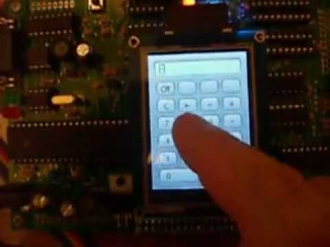

    Hey! Great work AverageJoe and Dr. Acula very impressive! What is the new number on the propeller pins being used is it still in the 20s?
    Thanks,
    Tyler
    edited 2012-04-18 21:21
    Good question re pins. I think it is 62 propeller pins. Ah you say - there are not that many pins on a prop chip!
    Common to all groups are:
    P30-31 is serial download
    P28-29 is I2C bus
    P24-P27 is the SD card
    P21 and 23 are audio
    P22 selects which group
    and P0-P20 are selected in groups.
    Group 0 does the 161 latching
    Group 1 does memory I/O eg hub to ram, ram to hub, ram to display, hub to display
    Group 2 does keyboard, touch input to the touchscreen, second serial port (with handshaking so it can handle being disabled some of the time)
    and the other groups are free for whatever you want.

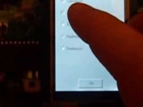

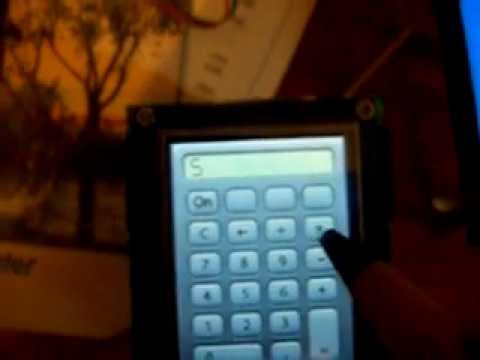

    Added checkboxes, radio buttons and standard buttons. (text input can be linked with the keyboard as shown earlier, and pictures have also been demonstrated, so these are the common objects used in a GUI)
    spin code:
    PUB Buttons | ck1x,ck1y,ck1s,ck2x,ck2y,ck2s,rd1x,rd1y,rd1s,rd2x,  rd2y,rd2s,rd3x,rd3y,rd3s,bu1x,bu1y,xval,yval,redra  w ' test out buttons, radio buttons, checkboxes

    640 x 480 - 40K

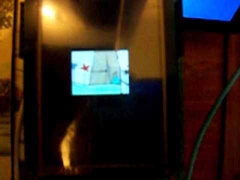

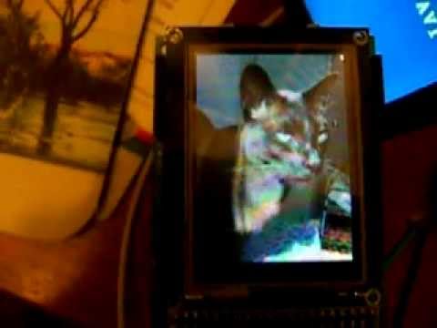

    *** Bitmap .bmp files now working *****
    I see on Facebook you have a breadboard made up - looking very good. And probably quicker to test things than the way I have been with getting PCBs made.
    I have been getting bogged down in the complexity of .raw files. Specifically, each picture has a size, and the size has to be stored somewhere, and if you forget what the size of a picture was, you can't restore it except by trial and error.
    So I figured that the .bmp format might be better than the .raw format. And then I figured that keeping track of all these pictures was getting too complex and was wasting a lot of memory allocating larger than the required amount. So I figured we needed a simple disk file system. The nice thing about bitmaps is they contain the file size and width and height. So I preserved that, and added in the filename so you can search for it later.
    This code reads in some bitmap files from the sd card into the sram, and then displays them in a different order. Just pass the filename and the x and y location and the routine finds where the file is on the sram and then displays it. Super fast display (max 30 milliseconds for a full screen) that is much faster than reading off the sd card:
      LoadBMPtoRamdisk(string("hotair.bmp"))               ' load a bitmap and increments ramdisk pointer
      LoadBMPtoRamdisk(string("cat2.bmp")) ' because we now have 4 Burmese cats!
      LoadBMPtoRamdisk(string("cat3.bmp"))
      LoadBMPtoRamdisk(string("nt.bmp")) ' nice picture of the Northern Territory of Australia.
      setorientation(false)
      result := DrawBMP(string("nt.bmp"),0,0)
      result := DrawBMP(string("hotair.bmp"),180,90)
      result := DrawBMP(string("cat2.bmp"),10,10)
      result := DrawBMP(string("cat3.bmp"),80,60)
    Bitmaps took a bit of decoding. Lucky wikipedia has a good description http://en.wikipedia.org/wiki/BMP_file_format
    The image is flipped upside down. And if the width happens to end up an odd number, it needs to be padded to a multiple of 4 (eg 109 width is 327 bytes which needs one extra byte to pad to 328). And just to really keep you on your toes, the pixels are BGR instead of RGB.
    Bitmaps are a very standard file format. Now I need to recode all the stuff up to now from .raw to .bmp. It should end up a lot easier.
    Code for the above routines. I probably could have made better use of Kye's string library for matching filenames. Maybe I'll do that later, eg change the case so it matches even if the case does not match.:

    Hmm, very interesting things to think about. I drafted up a quick idea based on 2 props. I tried to keep it as simple as possible. Thinking about adding a third prop in the "ring" but I think it's best to play with this idea first. The 245's are for fast bus transfers and such. I think it might come in handy. Any thoughts or suggestions?
  • jmgjmg Posts: 15,189
    edited 2012-04-24 13:56
    Very close, but I'd make IC15, IC17 74LVTH2245MTC (bus-hold latch, needs CMOS loads on DBUS), or a LVC543 for a 'proper' latch.
    - one issue is the 74LVTH2245MTC does not come in DIP, but you can get SO20, which is large.
    Some edge-to-pulse rate doublers dropped in would help speed too.
    Edit: Checked some more details, and you do need a 'proper' latched transceiver, for Ram READ.
    The bus-hold idea works on write, but on read you need to grab DATA while address is stable, THEN pass that data to the Prop.

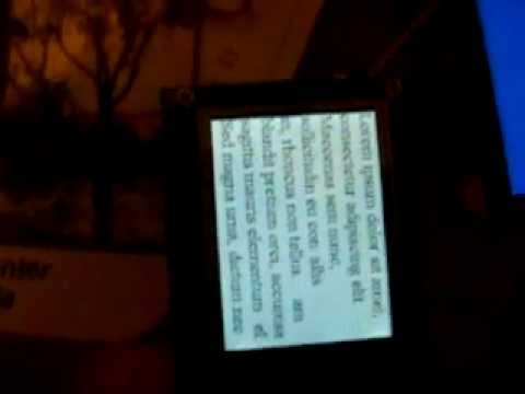

    While waiting for the boards, I took all the code and changed everything from .raw to .bmp files. Much easier to see what is on an sd card too by selecting thumbnail view in windows.
    I also have made the icon drawing faster by moving more of it from spin to pasm. Icons have a transparency layer so each pixel has to be tested.
    Bootup is faster. About 3 secs from pushing the reset button to having a background image, and another 1.5 seconds to draw all the icons.
    I added a textbox - see photo. Still working on things like word wrap and scrolling. One of the "hard" problems is going to be inserting text - if you insert one character do you shuffle all the text in the ram buffer up by one? Or do you have a smaller cache - maybe the current line of text, and only update the ram buffer when the line changes?
    Attached code. I can bundle up the fonts and .bmp files if anyone wants these. This whole project is open source.
