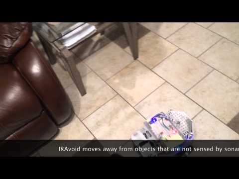

The avoid behavior needs to stop the robot and then back up away from the sensed obstacle. This means you must wait in three places. Once for the motors to stop, and a LONG wait again to back away until you no longer sense the obstacle, finally another short wait to stop again. Now your motor controller lets you fire and forget motor commands so awesome but if you return from the function and re-arbitrate then you're going to get called again because there is still an obstacle sensed, without some state tracking you'll be stopping constantly. With a thread you could execute all the steps in sequence using a flag of some kind to signal you are finished so the behavior will then stop wanting control. Without threads you either hog the CPU waiting to finish all the steps or allow run() to get called multiple times but only do the next step if the previous step is finished. Stages.
Here is the wantsControl() implementation. We want control if there is an IR Prox event OR if we are still in the middle of running from a previous event. We also do a little record keeping on what sensor caused this event. Later I want to make sure we notice if we have created another collision situation by trying to avoid this one. This is a simple avoid. We need to stop moving and then move away from the offending object.

Here's run(). We start off getting the latest prox data. Then if we were not active before, we set the active flag, advance the stage, and set a timer (for breaking out of a lock-up if needed later). Now we go on to execute stage 1. This would be a command to stop the motors and verify that they have in fact stopped usually quite quick. We advance the stage and return to allow another arbitration round. If we get control next round then we start moving away from the object and see if the proximity sensors clear. If not, we return and more arbitration rounds proceed. Each time if control returns to this behavior then we check the sensors and stop if the prox sensors show clear. So finally after a few hundred rounds that happens. Now we stop the motors and wait for them to really stop. Then we clear the active flag, clear the triggerBits, and set stage back to 0. Next round the bot is out of collision proximity and ready to do something else.
This prevents the behavior blocking arbitration during the long move away portion and allows a higher priority event to get through, like say a cliff sensor even while we are performing the current move.

This has been reasonably successful for me where the complexity doesn't overwhelm it and the stages are easy to divide up. There does come a point where it may be more advantageous to use a thread rather than this series of gated stages but I've been able to make it work for most simple behaviors. It keeps the robot very responsive to new events as they occur. One function I did not show is stop(). This basically is the way a higher priority event tells this behavior it's got to quit right now, reset and return. The arbitrator will always send stop to the previous behavior before running a new behavior.
Here's what the debug of this looks like:

[IR_Avoid] wants ctl. <--------- Here we trip an IR prox sensor.
Stopping [Sentry]
Running [IR_Avoid]
Behavior [IR_Avoid] has control
STOP | MOVE AWAY | STOP
STG 1 STOP
[IR_Avoid] wants ctl. <--------- Here we simulate taking some time to back up. Each time we just check to see if conditions are met andifnot we return.

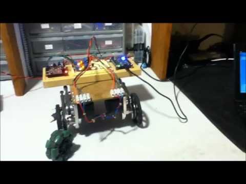

Are those VEX omnidirectional wheels? How do you like them?
I'm interested in using them in the EVE challenge for balancing on a ball.
Glad you find it useful. If you have any questions feel free to toss 'em at me. I'll do my best to give you a helpful answer.
VEX now has some nicer 4" wheels than it used to that are designed to use a matching hub. I don't care for the black plastic look of the hub they offer so it was off to the drawing board.
The new hubs will blend very nicely with the rest of the robot and make a much nicer overall look to it.
