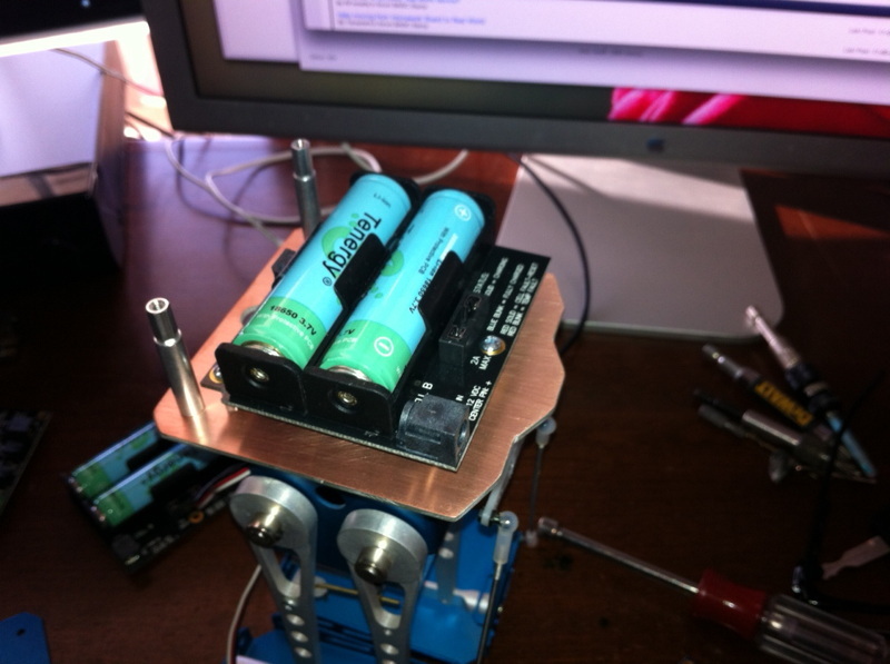

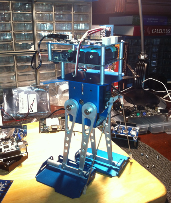

I have been tinkering with my Toddler again for the last few days and decided a transplant was in order.
I removed the original Toddler board and AA battery pack and replaced them with the Li-ion Power Pack-Charger and the MSR-1 Propeller Robot Control Board. I don't know if anyone else has done this yet and a search of the forums yielded nothing as such. I figured I would share as this progresses.
Next on the agenda - programming the beast!!

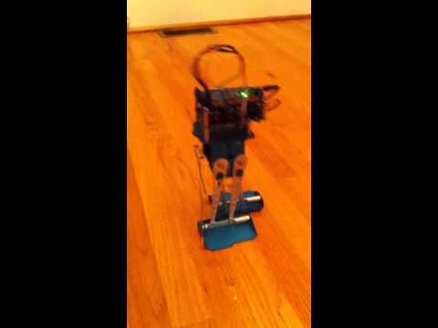

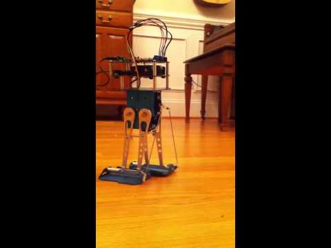

    UPDATE: Some crude walking accomplished! Need to fine tune still and will post some video tonight!
  • doggiedocdoggiedoc Posts: 2,245
    edited 2011-12-01 17:41
    VIDEO! Baby steps, but at least it's walking!
    [video=youtube_share;k7PjQnzGzTE]

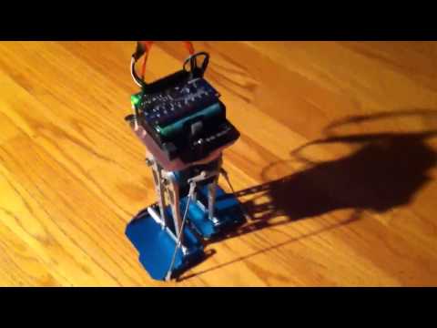

    Here's another angle... sorry it's so "yellow", dang incandescent lights!
    [video=youtube_share;mPPhcTkiL7M]

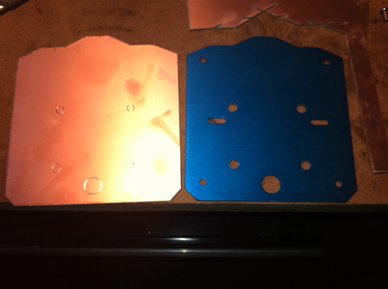

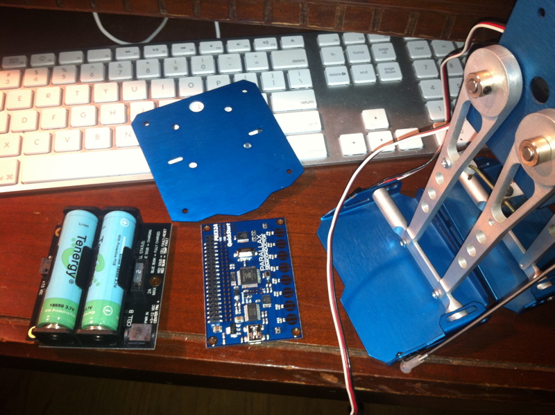

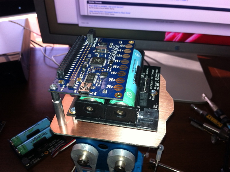

    Soooo...... I realized something. Using a discontinued control board may not be the best of ideas. I originally planned to use the QuickStart board since they are readily available and pretty inexpensive. Guess I'll get back to that! And I just got in today the smaller Li-ion Boe-Bot Power Pack-Charger and I already have a few P8X32A QuickStart boards.
    So I've got this to work with....
    Turns out the P8X32A QuickStart board and the Li-ion Boe-Bot Power Pack-Charger aren't directly drop in parts. I'll need to tap some now holes it seems.

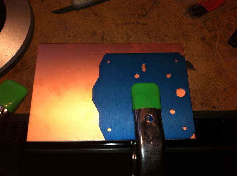

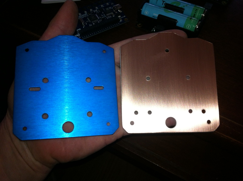

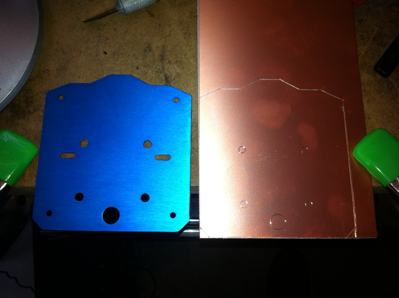

    Since I have a problem with drilling holes into my original Toddler deck plate, I decided to fabricate a new one. The best thing I had on had that I could easily work with was copper clad PCB. I used the original as a template.
    Then I used my dremel with a cutoff wheel to cut away the excess PCB.
    And finally, switched the dremel to the dremel press and drilled out the mounting holes and the holes for the battery pack.
    Now - I hope it mounts up strait! :D
    Paul
    edited 2011-12-04 12:36
    Yay! The holes are where they are supposed to be!! Whew.
    :D
    edited 2011-12-04 13:00
    Was that a scalpel job or hacksaw. :) Either way nice job!
    I like the way the QS looks on top. Sweet!
