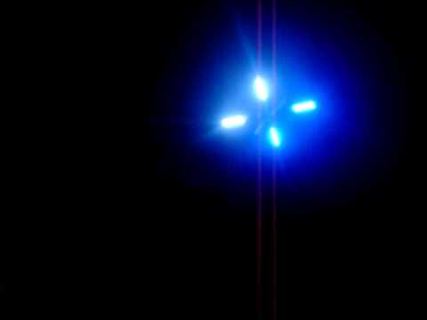

Tonight I took a night flight - amazing! I'm over at my dad's house and he couldn't believe the performance. The atmosphere is still and with the bright LEDs it was super easy to spot the quadcopter a few hundred feet up in the sky.

My first night flight with the new platform. After the video, and mostly after not crashing the first time up at night, I stayed out and drained the battery! It is super easy to see at night, even when I flew it down to the end of the court, about 300 feet away and 40 feet in the air! FPV here we come!!
Wow!!! Ok, i want one. Maybe for Christmas:) Those LEDs are so cool, plus the buzzing sound it makes is likened to a swarm of angry hornets. I remember somewhere it said that these would be sold for $250? And that would include the radio, control board and battery?
PS. Awesome job, they look like something you would see in a movie.
http://www.youtube.com/watch?v=WPU79OzASRk
Is what the headlines are going to read
The night lights look great
