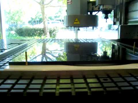

Hey Everybody!
Scott (our lead machinist) and I wanted to share a major success in our production methods today...
Our Router table (Haas SR100) has a 4x8 foot vacuum table capacity. We typically draw a vacuum with a significantly smaller vacuum pump than is normally used - we can do this by using non-porous spoil-boards and non-porous finished product material.
However, one of the issues that we run into is the requirement to *coax* into place the material as it is being "sucked" down by the vacuum pump. The volume (if you can call it that) of vacuum is typically quite small, which necessitates a larger pump.
Today we created a very large "vacuum reservoir", which as the video shows, makes the "suck-down" a no-hands, no extra weights, no muss, no fuss, event!
This may be boring to some of you, but it really is a cool addition to our "arsenal" of in-house capabilities :-)
Check it out:
This dramatically enhances our ability to produce (in this case) Madeusa and Eddie Robot Bases, and various "coming attractions", as well as our Solar Panels, etc.
