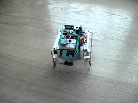

Progress update on the progress with building a cheap hex walker for under £30. I've posted the video before, but A couple of people have asked me for an upadte and more details over how it is put together. So here goes !
I've attached a PDF of my original design to this posting.
You don't have to be too precise about the dimensions, this is just what I scrounged together. I guestimate you'll need 20 hours, a drill, some 2 part glue, a jigsaw (with an aluminum cutting blade),a few screwdriver, a junior hacksaw.and some pliers. I'm happy to answer any questions
the walker before I mounted the battery underneath -this meant a minor modification but significanlty improved balance, (see the video)
raw materials -
from local DIY store -
on line from CPC - but almost anywhere :
Scrounged from elsewhere
