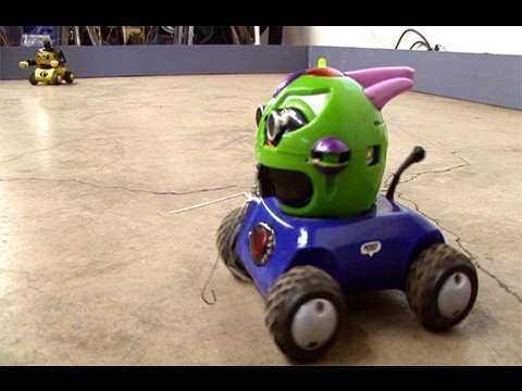

The Rumble Robot was a toy that was around a decade or so ago. It came with an IR remote control that kind of sucked. The idea was, you do battle with them and shoot a "laser" at each other until one became disabled.
Well they eventually fell out of favor. I found one at a thrift store one day (great source of hackable toys BTW) and decided to see what I could do with it. Little did I know that I'd end up going to Maker Faire with this creation and winning an Editors Choice award! Kip Kay was there and shot a video that he featured on "Weekend Projects". :)
Here's the project page on my website with full instructions on the build:
http://www.dinofab.com/rumblebot.html
Here's the code in PDF:
rumblebot code.pdf
Parts list:
1 - Rumble Robot toy
1- Arduino
1 - PING sensor from Parallax
1 - 100 ohm resistor
1 - microswitch
Hookup wire
Schematic:
PDF:
rumblebot schematic.pdf
Pics:
Videos:
This is a great robot platform to play with. There are others out there as well.
Pretty much anything with drive motors and an h-bridge.
LOVE that PING!
Happy hacking!
