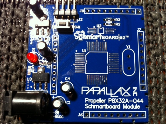

Hi all -
I purchased 5 Schmartboard Modules from Fry's today, but unfortunately they don't come with the Prop chip and some other components.
I almost didn't buy them since I was going to have to order the parts anyway - but I wanted to support Fry's since they carry some Parallax inventory at all.
So... besides the Prop Chip and crystal, what do I need?
Any help is greatly appreciated,

    The Parallax link above has a complete parts list on page 2
    edited 2011-02-14 02:13
    Looks like you need (part numbers in parens):
    the Prop (P8X32A-Q44)
    an eeprom (602-10001)
    the crystal (251-05000)
    2 10k resisters (150-01031)
    a 40 pin sip header that you will cut into 4 10 pin pieces (451-04001)
    a 2 pin header (451-00201)

    Ooops. I can't find the resistors or the rubber feet on the Parallax Store - so I'm ordering 5 of the kits and can use the extras to flesh out these boards. I'll have to conjure up some rubber feet locally.

    Wait till you try and solder R2 and R3
    I just finished mine
    12 dollars at frys chicago

    Just soldered on the first Prop, eprom, and crystal - but not found on in prop tool. I put sockets in for the crystal so I'm hoping that's it.
  • doggiedocdoggiedoc Posts: 2,246
    edited 2011-02-18 16:09
    OK, I'm a complete retard. The prop plug goes on flipped compared to the PEK. :D
