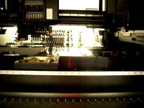

    Hey everyone-
    This morning the LION'S BEGIN ROARING off the Pick-n-place...whew!
    "In stock" status is a few days away yet...
    Edit: At least that was the plan. But, wouldn't you know it, I goofed...
    "pride goes before the fall"...I fell and will keep you posted!
    -Matt

    edited 2011-04-28 19:36
    Not a setback as far as design or capability - just a couple of silk screen omissions and relocation of a couple of components - not really "show-stoppers" - but it would not have been up to "Parallax quality" either. Now it should be :-)
    -Matt
