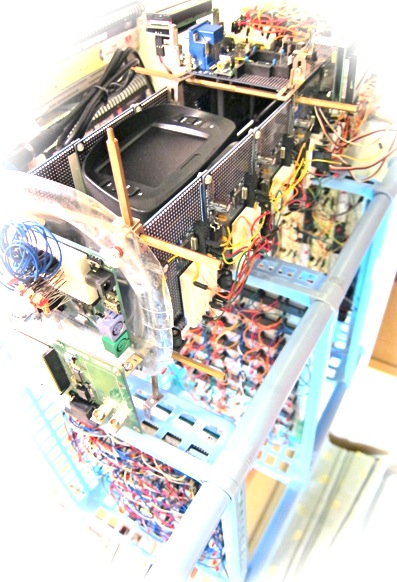

    And now I reveal the point of designing this huge propeller grid.
    A.C.S.E.R. Structure complete, wiring/soldering/programming up next.
    Dec 21st 2012, target completion date, confirmed.
    Initiate phase 2: soldering minimal antenna and firmware design for hydrogen resonance test.
    This initial design will require a minimum of 42 propeller chips, with a desired target of 84 chips.
    After tests with 84 chips, the next step up is to install and wire the maximum # of 504 prop chips.
    Yes, the final design will require 504 propeller chips. = $4,000
    Once the inital 42 chips are soldered and the system is working, and I have a running program, I will start a new thread in projects outlining the details of this device, its capabilities, tests, methods, schematics, pcb design files, spin programs, and more detailed video and images.
    The most important part of documentation will be the success or failure of this device to actually do what I intend it to do. Its (very likely)possible that other uses will be found as I start to test with it.
    Images show proper placement of propeller chips on one of the star like links in the frame.
    These are only installed at centers of all 3 axis.

    The black things in between each propeller chip and what the object this video is constructed out of, are k'nex plastic parts that snap together.
    I made an entire frame out of them to hold the pcb's, as also shown in the videos.
    http://www.knex.com/Educators/
    Feel free to start using them in your own ideas and projects, they are very useful, and easy to attach pcb's and wire up projects with stability and cheap price.
    The use of k'nex in the frame is just because I can't afford a 3d printer, or to have someone mill me parts.
    I suppose I could have made it all out of cardboard, and duct tape.
    The frame measurements were taken and pcb's were custom ordered to fit in the frame.
    Magnet wire was used because of its thin size, availability to me. Wire wrap could also be used.
    The circuit used in this design is exactly the same as the first post in the design(except it has a different number of them)
    In the 3d image above(the one with the colorful box, if you find the "Processor Axis" you will see all 3 axis in all directions.)
    The processors are also along axis surrounding the object, to connect to the outer pcb's.
    The reason the video doesn't show all of these processors is because as mentioned above, thousands of dollars are required, which I currently don't have.
