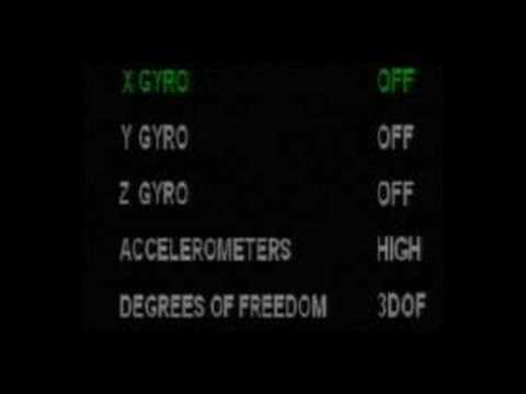

A gyro chip that can interface with an accelerometer chip and
has on-chip processing with I2C.
http://invensense.com/index.html
Video showing how it works on a cell phone
Video explaining the difference between how accelerometers and gyros work
