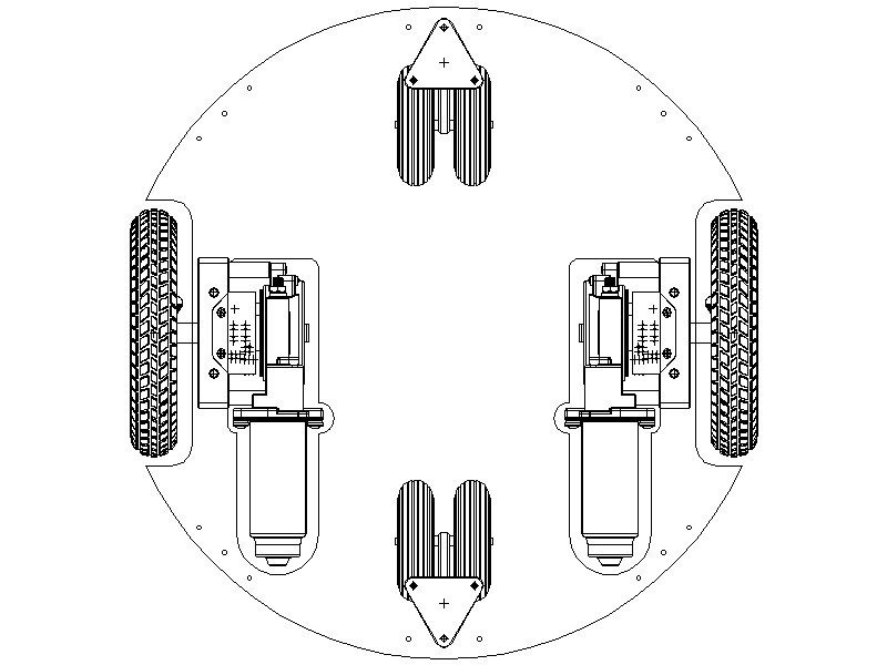

Hey everybody,
I'm building a new robot using our #27971 and #28971 kits. It's a round base from AL6061, 1/4" thick. The diameter is 16" and it includes a few cutouts for the motors and numerous drilled holes. Finish is to be grained; no anodization required.
This is too big to fit on our CNC milling machine, so I'm looking for somebody who can do it for me next week. We will pay you or trade hardware, or a combination of both (your choice!).
Can anybody recommend a company to do this for me?
Thanks,

    also look at http://bigbluesaw.com you can upload a dxf file, pick the material online.

    Your part has mirror symmetry (assuming the holes go all the way through). You could easily do this on your machine by making two identical pieces and scarfing them together:

    If you have a CNC that can do a bit over half the size, then you can use the trick I have used in the past. Add a 5 hole set in the middle, 1 in the middle and a diamond 4 around it. Then put the alum on the mill with half sticking out the front, clamp well!. Mill half the shape, then rotate round the center hole, aligning the diamond up, rotate the CNC diagram and mill the other half. You could do quarters if the X isn't long enough but that is a pain to get right.

    Thanks for all of the great suggestions. @Phil & Timmore: I understand and I have used this method in the past. It works but I don't prefer it due to setup time. I'd much rather see this milled in one piece and wait a few days.
    @Peter: okay, will send you the files instead. I'd rather work with our customers whenever possible.
