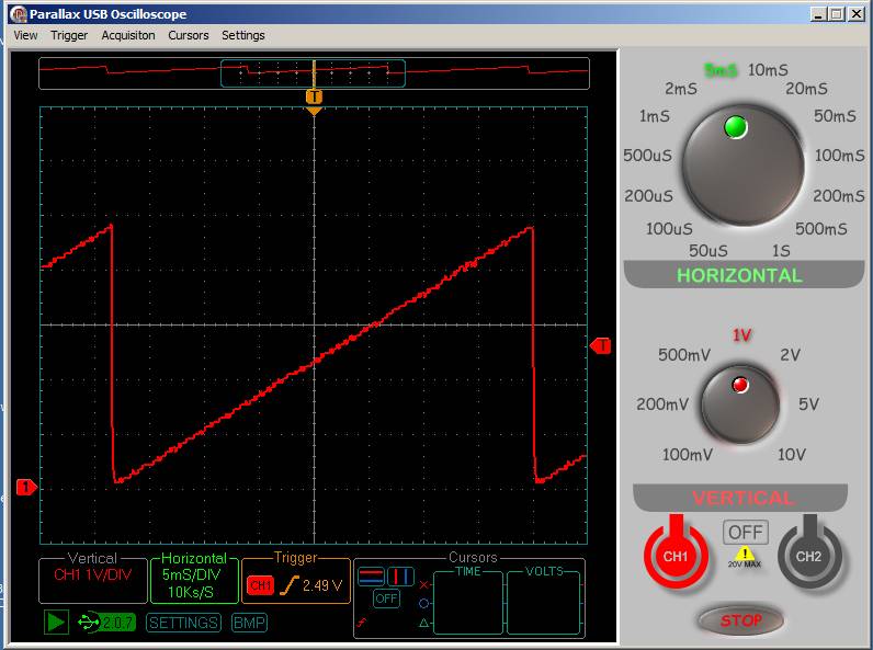

Here is a program I've been working on. Thought you guys would find it interesting.
I'll post an oscope picture as soon at I get back home.
EDIT: corrected pdf
Bean.

    Bean,
    Cool idea. However, I think it's easier do than you think it is.
    Imagine that you have a theoretical 3 bit DAC, but treat it as a DAC that can only output up to the highest binary value. This would mean from %000 to %100. Now, imagine that you simply wanted to double the output range of this DAC using your method. We want to turn 0-4 into 0-8. Divide 8 by 4 and you get 2. Now suppose you want to generate the value for 7. Well, 7/2 = 3.5, thus we toggle equally between 3 (%011) and 4 (%100). All other values follow suit, e.g. 5/2 = 2.5, so toggle between 2 and 3.
    Now lets increase the output range further. Lets turn 0-4 into 0-16. 16/4 = 4, so there are 4 in between steps, so our PWM rate is now 4X. To output 15, do 15/4 = 3.75. We need to toggle between 3 and 4, only we output the value 4 three times and 3 once. To output 14, we have 14 / 4 = 3.5. This means output 3 twice and 4 twice. 13 /4 = 3.25, so output 13 three times and 14 once. 12 / 4 = 3, so simply output 3 all four times.
    This approach will scale up to your 256 levels just fine. The key is to "throw away" some of the DAC's potential resolution in favor of making the math simple. Remember, even though we talk about 8 bit DACs having 256 levels, zero is a legitimate value and thus the top end is 255, not 256. By treating the DAC as if it has a top value equal to the highest binary power, we get to do simple bit shift division, yet still get all the output values we want.

    The accumulator approach doesn't solve the problem Bean was trying to solve. He wants to reduce the oversampling needed to have create 8 bit resolution output. With normal PWM or the accumulator approach, if you want 256 levels of output, you need to run at 256 times your desired maximum output clock. His approach is to increase the number of pins while decreasing the oversample rate.

    What am I not getting here..... the accumulator approach gives 256 levels of output, all with negligible overhead, and does so in the ISR as a "background task".

    For example,
    to output a sinewave in 32 8bit DAC-values:
    The accumulator approach requires 32*256 interrupt cycles to complete.
    If you were to use 8 pins and a R-2R ladder network, then all you need
    is mov port,variable to set a DAC value, and the sinewave will be
    completed in just 32 interrupt cycles, so you will have a higher frequency
    output.
    regards peter

    You can think of single pin PWM as modulating a single bit DAC. The article just shows how to implement a 3-bit DAC with modulation.
    Instead of dividing my 37 (instead of 32) another method of implementation is to have a second LSB bit (so a forth pin with a 4K resistor). In this method, after setting the 3-bit DAC with (Value / 32)This "second LSB" pin is then the only pin toggled just like standard single pin PWM (with value // 32 * 8) . Of course this requires 1 more pin and another resistor.
