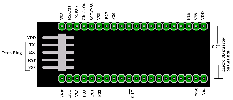

    bread board pin pitch is 0.1" also this package is slightly different pin out but if vertical height is not a problem for a temporary fix an adapter board could be easily made. Pins can be in order of the layout below or I can put the header in upside down and flip the pins around. The fliped orientation would be recommended for the uSD card if you want people to see it otherwise the uSD would be on the bottom of the module though still accessible.
    The uSD card if used uses P0-P3 as in examples in SD fat16 object
    It makes no difference to me if the RTC is on or off. The RTC can not be added later though so if you think you want it then I recomend getting it.
    VDD and Vin are connected on SD Module.

    I made a small error on the pcb layout for the adapter. Here is the corrected. You can chop off the pins to the left of board they give you access to Vbat, Clock Out which are only used if using RTC. Vbat is only needed if you chose to use a different battery then the normal 9mm. Also gives you access to Vin which is only on the Power Supply Version.
    The header row slightly shifted left is for the prop module and should be female on top or soldered directly to prop module.
    The header row slightly shifted left should be male pins below board and align with the standard prop package.
    Pin 1 for each is on the bottom left.
    I can get the boards made in quantity of 2 for $10CAN(each) or you can make them yourself.

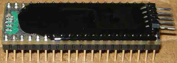

    this works on the principle of not allowing physical access to the data.
    How can you access the data on the prop?
    1) if you have access to the SDL and SCL from the eeprom you can download it direct
    2) if you have access to the prop RX and TX you could load a program in ram that sends the eeprom contents back to you
    With this module there is no way to access the SDL from the EEPROM because the board is encased in epoxy. You can access RX and TX to program the module but once you are done you can blow out a fuse removing access to RX by following these steps:
    1) remove power
    2) shoring VDD and VSS
    3) apply power source positive lead to VSS(outside pins of programing header), negative lead to RX(middle pin of programing header)
    as long as the power source can provide at least 250mA it will blow a fuse making it now inpossible to reprogram the module. Your data is secure.

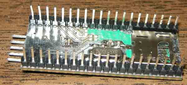

    edited 2009-02-25 03:15
    pictures
    600 x 216 - 8K
    600 x 274 - 15K

    edited 2009-02-26 03:26
    Well I got the boards back together today and have a program running on the first of the moduals assembled. Will figure out how to make a video and make link when I am done.
    here is the eagle package file for the sd module. note that in normal orientation there are a few locations noted in tdocu layer that you must keep clear of parts otherwise though you should be able to place parts underneath the module.

    Hmm, you keep using the word "secure". I don't think that word means what you think it means.
    This is not secure; at best it is slightly inconvenient for somebody with nefarious purposes.
    As someone previously pointed out, epoxy != security.
    Secure means that it should be resistant to attack to someone if physical possession of the module.
    Jo
    edited 2009-02-28 06:03
    well it is true it is not 100% secure. This is not possible ever.
    You can not download the contents of the eeprom with out first cutting through the epoxy. That really is the best that can be done with the prop.

    X-rays - This module is going to get very heavy.
    edited 2009-03-01 06:20
    well i don't want to make it heavy. if i could get some kind of container to hold in the resin I could do 2 layers. 1 to protect and electrically insulate. another with metal filings or something to make x-rays harder to interpret.
    any ideas on either? right now my bigest problem is keeping the resin from spilling over the board edges but still being thick enough to obscure position of ics. requires a lot of babysitting.

    It's not worth pushing this security idea any further.
    A quick dip in DYNASOLVE 165 soon has the thing de-potted ready for sniffing or reprogramming.
    www.dynaloy.com/Products/tech_data_sheets/Dynasolve%20165%20PDF.pdf
    edited 2009-03-01 06:58
    well unfortunately it is illegal to pack explosives around the eeprom that go off when tampering is detected(works great though).
    still I can just make it as secure as possible and hope it is not worth the bother.

    "Dynasolve 165 is not selective and will attack most thermoplastic
    materials, wire coatings, and many thermoset coatings and materials. It will also discolor and etch aluminum."
    I wonder how much of the eeprom would be left after a long bath in such a solvent. Heater do you have any of this solvent to try this?
    From the datasheets what they don't tell you is how long the solvents take to break down the bonds. In my experience with a similar solvent its a couple of weeks (100x50x12mm), perhaps quicker with agitation and/or scraping.
    Anybody know what happens to these solvents when applied to lithium batteries?
