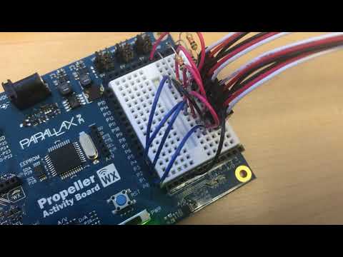

    Okay, I built a BOM from the parts we have in our inventory.
    (4) 350-00038 Sharp GP2A25J0000F Sensor
    (4) 805-28107 Cable for ActivityBot Encoder
    (4) 150-02210 220 ohm ¼ resistor
    (4) 150-01030 10K ohm ¼ resistor
    (4) 451-00303
    (2) packs jumper wires
    $29 of parts we will sell for $15 each. 250 kits to be available.
    Here's a look at what we're dealing with:
    I can use all of your ideas. If any of you are highly motivated by this little project and want to make something to share (Phil's Music Box) or similar, drop me an e-mail and I'll send you a bag of parts kgracey@parallax.com
