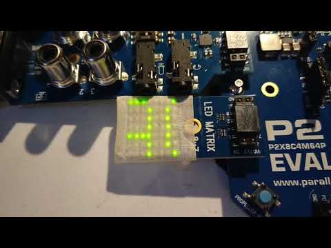

-LED Matrix.
First thought was why 8x7 not 8x8 but then I saw charlieplexing. So it needs constant refreshing if more then one line is used. Not really nice, but usable.
Having a shift register or two would ease that pain, but it is what it is and @Peter Jakacki already writes Characters on it...

  • Here's about a few dozen lines of TAQOZ code that implement a scrolling display on the charlieplexed LED matrix board. I fixed up the orientation to 8 columns of 7 rows (I thought I had it that way the first time, apparently not), and now a new character is written into the non-visible part of the 2 character buffer while the Charlieplexing task will start scrolling this character into view when it detects it. The software takes about 330 bytes of code including the table but rather than doing a simple message buffer, this is a proper TAQOZ output device where we can redirect all output to it as we would to the serial console like this:
    PLEXLED ." Hello World! " 500000000000000000. SQRT .

    Here's a cheesy, little spin program that displays characters on the LED Matrix accessory board. Fastspin was used to compile as P2...
    EDIT: a new version of the main source file is attached. It uses Cluso99's mini font, which displays much nicer on the LED Matrix board!
    The source and 2 OBJ files are attached as an archived zip file. Excuse the ugly font, included in the DAT section.

  • Here's the game of life on an 8x7 LED matrix. I converted dgately's Spin2 program to C, and then implemented the life game. It runs under p2gcc, but it shouldn't be too hard to get it to run under spin2gui.
    I also created a drawByteImage() function that works with a 8x7 byte matrix. It implements gray scale by varying the amount of time an LED is on as a function of the byte value. I don't use that feature in the life program, but it might be useful.

    Here is a version of dgately's demo which shows how to charlieplex a regularized bitmap 7 LED's at a time, so it is actually visible in a lighted room. This also smooth-scrolls the message, and includes a 5x7 font I drew a long time ago for a dot matrix printer with a couple of lowercase characters moved up to remove descenders.
    Edit 2: Modified program to automatically work properly with any basepin.

    Not getting any result other than P57 blinking (BTW: I mod'ed to use P32 as base)...
    dagately
  • localrogerlocalroger Posts: 3,393
    edited 2019-02-06 - 20:16:28
    I'm not using Pins, so you have to change the outas to outb's to use basepin 32 or greater.
    edit: Added a comment to this effect to the source file
  • localroger wrote: »
    Good news... Works!

    Here's the 5x7 font I made up for VGA and also use on the LED. I can dump in any suitable format, all it needs is a good one-liner in TAQOZ!
    BTW, my last iteration of the LED display gives all 56 LEDs the same delay regardless if they were active or not so that the brightness is even for all characters and the scrolling smooth. The previous version was brighter but that varied depending upon the number of LEDs that were active.
    TAQOZ# font5x7 $20 7 * + 96 7 * ADO CRLF I 7 ADO I C@ .B ." ," LOOP 8 EMIT SPACE 7 +LOOP   ---
