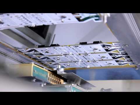

    A video of DEFCON 22 badge manufacturing:

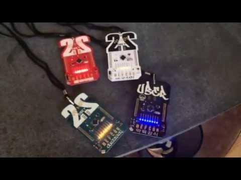

    A short video showing how the Uber badge controls the other ones. - Ken

    Want to upgrade your badge to a Goon badge so you can get some interaction???
    Instructions:
    1) Download goon firmware: https://pwn.me/dc22/goon.eeprom32.bin
    2) Follow the links above to install PropellerIDE
    3) Detatch USB and power-cycle.
    Execute propeller-load -e goon.eeprom32.bin
    Enjoy!
