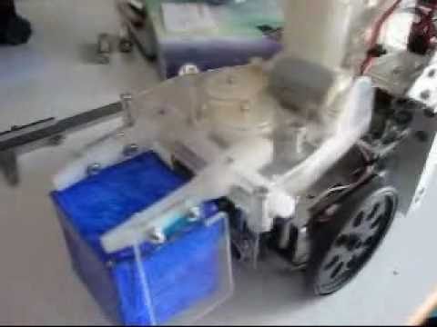

    [size=+2]Part2: the use of sensors for color and size recognition [/size]
    One of the most important parts of this challenge that faces the robot is to recognize simultaneously the color and the size of each cube. For this purpose the robot uses two very popular Parallax sensors: the ColorPAL sensor for the color detection and the PING))) Ultrasonic Sensor for the size detection. In order to put together both sensors and manipulate their data I made an aluminum frame to hold them. The frame with the sensors is adapted in the front side of theBoeBot.
    Here is how it works:
    Both sensors scan the area in front of the robot. If there is nothing close to the robot the ultra sonic sensor detects a distance d>=4cm (I have measured that a cube is close to the robot and the robot can catch it when its distance from the robot is < 4cm). In the same time the ColorPAL sensor detects the “BLANK”. In this case the robot has nothing to do except to move forward in order to approach a cube.
    Supposing the robot approach a small red cube. In this case the ultra sonic sensor will gives us a distance smaller than 4cm. This data indicates that “something” exists in front of the robot. In the same time the ColorPal keeps on detecting the “BLANK”. So we can understand that a small cube exists there. The Basic stamp gives the appropriate command to the gripper (How much the gripper should close in order to catch the cube).
    In the next step the gripper grasps the cube and picks it up according the BasicStamp order
    As the gripper lifts the cube up the ColorPAL detects the color for another time. Now it can identify that is a small red cube.
    Supposing the robot approach a big green cube, the ultra sonic sensor will gives us for another time a distance smaller than 4cm and the ColorPal detects the “green”. So we can understand that a big green cube exists there. The Basic stamp gives the appropriate command to the gripper (At this time the gripper close its parts less because it has to catch a bigger cube).
    Finally the gripper elevates the big green cube
    We can use the ColorPAL again to assure the cube’s color although it is not necessary for Big cubes.
    We use the same method to identify and the rest types of cubes.
    Here is the “flow chart“of the algorithm described above:
    And here is a video showing the above procedure:
