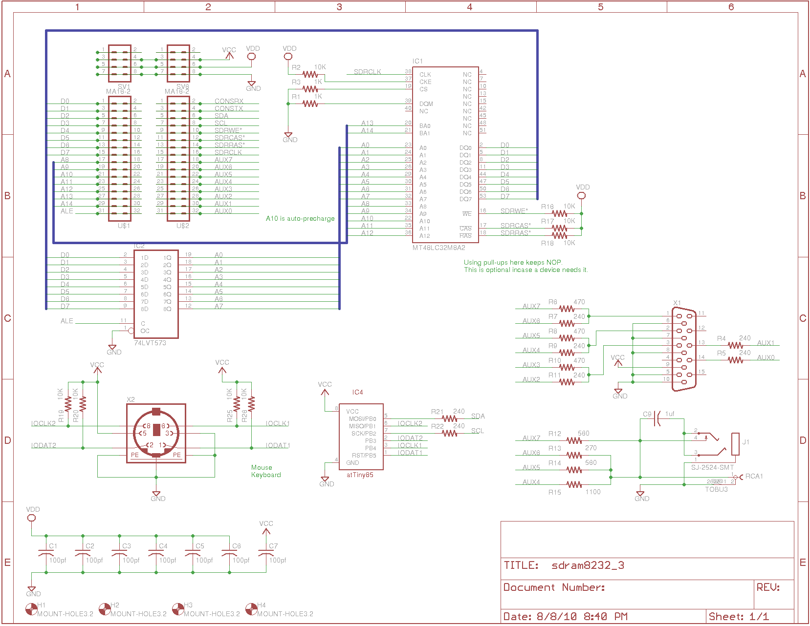

    On the image resolution ... I tried uploading the .png several times since I know .png is practically lossless. What ended up being posted appears to have been converted to .jpg since there's lots of "eddying" in the image. Slightly disturbing. I used a different color scheme since others mentioned that the one I like was hard to read.
    Here's a link to the new schematic; I can't shrink it without losing detail. The VGA connector and TV/headphone connectors overlap in the FAB to provide a stuffing option. A board with no connectors can also be made.
    http://www.brouhaha.com/~sdenson/propeller/sdram8232_3.png
    There is a unique experimental option on the schematic that I don't think anyone has tried and this schematic spills the idea out there for anyone to use/try. Since it's there to see, it would be nice to know if anyone thinks there's a chance in heck that it can be made to work. I'm concerned about the voltage configuration ... any thoughts?

    Hi,
    With ZOG comfortably running on 32MB SDRAM, it's time to update the hardware.
    The 32MB Gadget Gangster module should provide a 2 board Propeller Computer solution on any Propeller Platform board.
    After chatting with Nick about the Gadget Gangster platform boards, I've decided to go with a *long-board* so that I can fit a micro-SD card and two separate mini-dins for keyboard/mouse on the design. The TV option will be used for the Propeller Computer, the VGA is a stuffing option for hi-resolution textured video experiments.
    Here's the feature-set:
      Memory: 32MB SDRAM available for ZOG or other compilers. Language compilers must provide at least 25 bit addressability.
      Video: TV & SDCARD (or VGA without SDCARD).
      Audio: Optional TV audio headphone connector (0.25" or 0.125" possible).
      SDCARD: Push-push type on the right pins - no hardware hacks required.
      Ethernet: SDCARD pins allow optional Gadget Gangster E-Net module use. Ethernet or SneakerNet your choice :)
      Keyboard: Accesible via I2C and atTiny85 AVR.
      Mouse: Accesible via I2C and atTiny85 AVR.
      AVR: DIP-8 Allows for custom code connecting to Keyboard/Mouse port pins. Optional applications include I2C interface A/D conversion on one or both ports.
    Input or feedback on the design is welcome!

    Its looking very good, jazzed. I thought it was looking short on resistors around the KB and Mouse but thats because of the avr running at 5 volts. One minor addition would be to put a USB A footprint as well as PS2, since you have room. You can get USB female A's that hang over the side of the board (so their shell wouldn't short anything)
    Tubular, can you explain how the USB connectors would be used?
    Thanks.
    --Steve

    the USB A's can be used with the keyboards and mice that support dual PS2/USB mode. Ie it eliminates the clumsy PS2 to USB adapter required with many modern keyboards or mice.

    Jazzed anyway you can enlarge the schematic for some reason I can not
  • jazzedjazzed Posts: 11,803
    edited 2010-10-06 15:03
    vettezr1 wrote: »
    Sure. Is this better?
    In Google Chrome I use Ctrl++ [press and hold Ctrl and + at the same time] and the web page content gets bigger. Ctrl+- makes page content smaller. I looked around and it seems Firefox and Internet Explorer also support Ctrl++ (and for those who use Opera, I'm sure there's a way to do it there too). I don't know how clicking the attachment would work ... it just seems to show a box with an X-it control.

    I think He mean SCH on page 1

    The schematic on page 1 is out of date. I'm not sure if I'll be posting another one any time soon. My priority is to get the latest hardware tested and into production.

    How is your board coming along?
    The SDRAM design works fine. I'm still developing the I2C mouse/keyboard section - sometimes I wish this was a separate module, but I think it's important for users who want a Propeller-PC with gobs of memory. The mouse works great, but I don't have the keyboard fully functional yet.
    What is the top speed?
    The highest burst speed is 10MB/s (note 1).
    A 64 byte page access speed is 5.3MB/s (note 2).
    All performance measured on an 80MHz clock system.
    Memory Performance Notes:
    1. The top speed is 10MB/s. That is the rate at which bytes are read/written in a single burst after an address phase. That's "putting the best foot forward" as some people say :)
    2. The most useful and realistic measure is page write or read speed. A 64 byte page write or read clocks in at 5.3MB/s or 64 bytes every 12us. The longer the page, the faster the access. Page access performance is useful primarily because of caching as I've implemented for ZOG. I have a VMCOG version also, but it is slower because there's no room for fast page brusts; VMCOG also can not support 32MB.
    What is the turn around time for a byte, word, long?
    Byte at a time access speed is 0.5MB/s.
    Dreadful of course :) When forced to read or write one byte, word, or long at a time, access would be about 0.5MB/s for 1 byte, near 0.9MB/s for a word, and near 1.6MB/s for a long (any of these accesses will happen in about 2us). Considering the setup time is the prevailing factor, the time it takes for any single access is about the same. The more you access at one time the higher the throughput.
    What are some possibilities?
    Nick and I are building more boards this week. The common assembly will probably be a board that supports 32MB SDRAM. Different flavor boards can be built according to instruct-able documents and may include one of the following configurations:
    Configuration Notes:
    1) 8MB to 64MB SDRAM is possible, but the only shipping configuration will be 32MB (Development/testing of other sizes is negotiable).
    2) VGA can not be used with SDCARD, Ethernet, TV+SDCARD, or TV+Ethernet.
    3) An I2C attached up to 3 single end channels 5V range ADC is possible instead of Keyboard/Mouse - can have 1 differential channel ADC.
    4) Theoretically possible with a new LCD module board to be designed.
    8 Propeller pins are free for any use when only SDRAM is attached.
    Note: At this time the I2C Keybd and I2C Mouse are not "officially supported" on the SDRAM board.
    Keyboard and Mouse working simultaneously requires the RESET pin to be set permanently to I/O.
    A forthcoming boot-loader will make reprogramming possible regardless of the RESET pin feature.
    Once the boot-loader is available, the keyboard and mouse will be officially supported.
    Hope that helps. Cheers.
    --Steve
