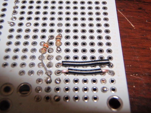

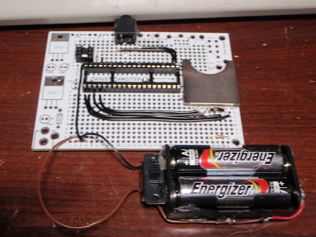

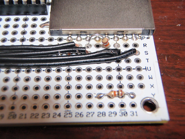

Are you sure all Propeller grounds and power pins have good connections? There should be 0 ohms between the ground and both propeller ground (pins with power off).
What else do you have connected? Can you post pictures of front and back of the board?

Where is the crystal mounted, I don't see it it the picture.

Ok, you are battery powered but there will still be startup surges etc. So of the above 5 caps you could leave out the 470uF one.
Can you post an updated photo of both sides of the board?
