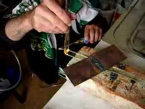

Browns Gas at work
If you are thinking of burning water to make fuel then you need to look at Browns gas.
The bottom line is producing more than enough hydrogen gas than it takes to make it. Using
frequencies in the RF range makes it more efficient. I don't know if that is what you are thinking but
you need to look at this site if you plan on sending an rf through water to produce combustion
.. http://www.brownsgas.com/brownsgashome.html
