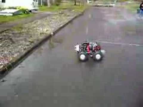

    Hey Guys,
    So it turns out that the QuadRover uses four solenoids and three servos to control it:
    A left motor enable solenoid
    A left motor direction solenoid
    A right motor enable solenoid
    A right motor direction solenoid
    A throttle server
    A left brake servo
    A right brake servo
    The solenoids work off of 12 volts and draw about half an amp each, the servos work off of 5 volts and also draw about half an amp each at stall. So I needed to design a hefty 5v power supply and relay circuit so that the propeller could control all these parts.
    Note this is only a prototype for right now so that we can get the rover up and running. Later designs will probably use solid state MOSFETs to control the relays, as they are more reliable. Oh and for those of you that can't wait to get their hands on one of these rovers, lucky for you guys I believe parallax is designing a control board that will be included with the rover.
    Anyways I just wanted to share these pictures, so enjoy! Oh and if you were wondering on if it was hell to solder... it was... it took me about three hours of planning and soldering.
    Feel free to ask questions and make comments, a circuit diagram will be available upon request.

  • Levy (OSURC)Levy (OSURC) Posts: 10
    edited 2008-03-19 03:24
    Hey Everyone,
    The moment·we all have been waiting for has just arrived... Our first video post of the rover driving! Today we were lucky enough to get a break in the rain so we went out with a video camera and took some video of our sweet QuadRover. I have posted the two best videos on YouTube·(links below) so go check them out! Please vote and comment, and if you’re a registered YouTube member subscribe to our channel and you will get notifications as soon as we post more videos. The first video is a demonstration of the rover, check out how easy it is to start! The second video is a test to see how well the QuadRover can climb over obstacles, that curb is just over half the size of the wheel, and look how easily it gets over it! Hope you guys enjoy these videos, if you want to see anything specific in the feature please let us know.
    http://www.youtube.com/watch?v=4rEVZG1aGYM
    http://www.youtube.com/watch?v=fyoPwR8uw80
    Jordan
    edited 2008-03-31 05:59
    Hey readers,
    Good news! We have the rover driving around wireless with our new control system and we have video of it!!
    Oh and did you know that the QuadRover can pop wheelies!? Well it can, go check it out in the cool new videos.
    Jordan

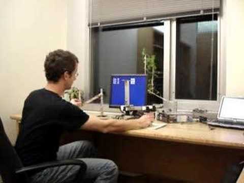

  • Shuman (OSURC)Shuman (OSURC) Posts: 12
    edited 2008-04-03 23:24
    Hi Everybody,
    Work on the control for the robotic arm has gone well. We're going to use some telerobotics to control the robotics for this project. We're going to make a controller arm for the control tent that mimics the rover controller arm. The controller will move the controlling arm and the distant robotic arm will mime the actions. Our AX-12 servos were back ordered and will take about another 7 days to arrive, but we'll be ready for them.
    Attached is the schematic and picture of this setup.
    There's also a YouTube posted:
    Matt
    2272 x 1704 - 754K

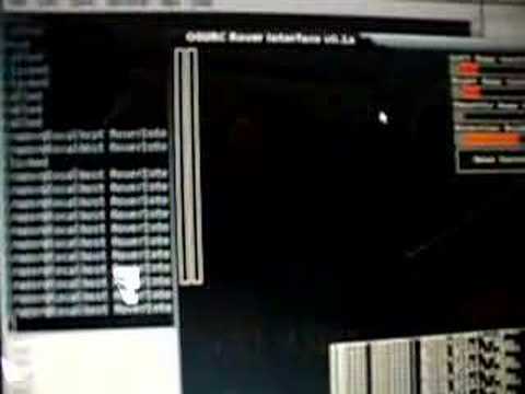

  • Goska (OSURC)Goska (OSURC) Posts: 3
    edited 2008-04-08 01:35
    Hi everyone. I've been working on serial communication for a while now, and recently I had to use hardware flow control. Now, I was probing lines when using hardware flow control with a computer, and found something interesting. When using hyper terminal and hardware flow control, the computer didn't even respond to changes in the CTS line, but when using a terminal program in linux (gtkTerm) I found that it did respond. Lesson: Don't trust hyper terminal. Anyways I got flow control running properly and attached are oscilloscope screen shots from when I was testing.
    1024 x 768 - 57K
    1024 x 768 - 71K
    edited 2008-04-17 03:43
    Hi Readers,
    I've been working on assembling the robotic arm for the rover this past week. Here's a link to a video that shows our concept. We're going to finish assembling the arm this weekend, and it should be turning bolts by Saturday. It's really fun to operate and we're excited to start getting some interesting videos posted on this forum. Let us know if there are any features or questions that you'd like us to talk about or photograph for you.
    Video of the arm moving with a controlling manipulative:
    Matt
    edited 2008-05-19 06:19
    I've been working on the interface and making it a little more organized recently. So I introduced a tabbed interface. This allows me to keep only information/buttons/interface elements that are important to the current task on the screen. Also I added a simple input box so that I can send any command to the rover even if there is not a button. Attached is a screen shot. Other improvements to the code include a complete re-write of the packet send/receive mechanism so that it actually works properly even under error conditions now.
    1280 x 800 - 133K
