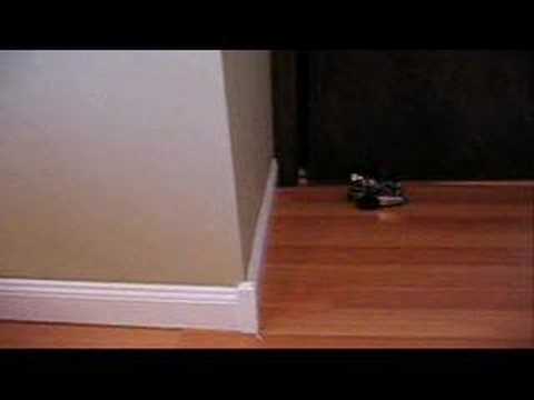

Standard Boe Bot, HM55B compass, PING))), eb500 BlueTooth, ir bumpers, ServoPAL. Unit navigates w/standard ir bumpers as primary avoidance mechanism. Ir bumpers are queued 8 slots deep to determine ambiguous obstacle state whereby a 180 degree ping sweep is performed. Data is fed via eb500 to StampPlot for view. Maximum ping distance is translated into a relative bearing and direction and then into an actual heading value to which the boebot is directed to turn. Current problems: 45 degrees to smooth surface is sensed as max distance (seen in video). Possible enhancements include the addition of directional biasing code to direct overall roaming performance.
Video at:

At 45 degrees, a 0 degree reading should also be max (and 135 degrees and 180 should be max also on smooth surfaces) could you - if 45 and 0 equal max or 135 and 180 equal max. rotate the bot 22.5 and read again?
