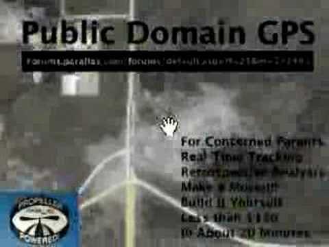

The Alpha/Beta is done... it works!!! Having trouble uploading to YouTube...
working on the docs. Will post it all by tomorrow, for sure.
My implementation uses AppleScript and ImageJ to generate the movie from the Prop-GPS data, do the analysis and generate reports. I would be very interested in seeing how the same sorts of things are done in Windows.

This set-up allows programming the Prop on the 96. Once programmed the hook-ups on the right side are no longer necessary... meaning you need the GPS, the 96, one capacitor, one resistor, a 9V power supply and a voltage regulator...
I'm waiting for permission to re-post one of the objects. If I don't get it by tomorrow, I'll archive everything else and just point to the object.
Well, I still haven't heard from one of the authors.· So here is the spin file with directions to the other objects.· I'll be adding project·documentation and a scripting application later.
oh... I almost forgot. There is an error in the photo... there should be a jumper across the red power rail... otherwise there is no power to the uoled!!!

oldbitcollector: this saves a movie as a sequence of images to your default folder... you have to set your keyboard preferences so that the "1" key triggers a screen shot... or change the keystroke line. This is Applescript... so it only works on a mac... would be interested in seeing how it is done in Windows.... AND I think I have figured out how to do it with just a Prop[noparse]:)[/noparse]) and WITHOUT Google Earth.

This project is a long way from being done... the biggest problem, which I'll fix first is that it always writes to the same file. There is no menu system...
Right now I'm generating reports using Applescript... which let's me print from my Mac. I'm planning to replace this with a "home" base station based on a Prop and the uoled 128. I would like a little printer to go with it... and I'm thinking that the ink-jet stuff that Parallax offers looks really good right now...[noparse]:)[/noparse]
Right now, this only allows you to see where the GPS has been...not where it is, so I'm planning to follow some prior advice about adding cell phone support.
Everything is going to be Public Domain... So, if anyone else wants to jump in, everyone is welcome. Printer support would be nice.
By the way... this project is a perfect example of why the Propeller is (or soon will be) an integrator's dream. I'd put this at about a 2 on a scale of difficulty of 10... really simple. The only problems I had are those that I created myself. My guess is that this could have been hacked together in under a day given just the source objects and no prior knowledge of Spin.
Which I think is a good challenge for interested companies... if you think you might be interested in the Propeller but you are worried about the learning curve... give just the hardware and the supporting objects to a programmer and give him two days to bring you a product prototype... it can be done and if the guy can't do it... hire someone else.
