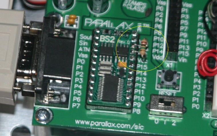

Last week I was assembling my 3rd BOE-Bot. Everything seemed to go just fine. However, a problem arose when I ran my hello world code to check everything out. The editor would not consistently find the Basic Stamp. After checking all of the connections a few times I finally re-seated the Basic Stamp in the socket (by removing and reinstalling it). It would work about 50% of the time. After some frustrating fist banging I swapped out the BS2 with another from one of my other BOE-Bots. That worked flawlessly. Therefore I deduced that I had a bad Stamp or had damaged it on installation. Naturally, when I reinstalled the "bad" stamp the problem returned. With some experimentation I determined that the editor recognized the stamp when I applied a slight amount of pressure to the BS2 with my finger. Figuring it was already toast I experimented with different amounts of pressure in different areas to try to determine if I had a bent or broken pin or the like. Finally I was able to figure out that it wasn't the pressure but the fact that I was touching the stamp and where I touched it. I found that by placing the tip of my finger gently over pins 21 and 22 that the editor would identify the stamp every time.
Ok, so I am no engineer, and my question is this. What connection is my finger providing between pin 21 and pin 22?
I found that a jumper wire did not work and theorized that my finger must have some inherent amount of resistance. So I experimented with a resistor between the two pins and found that lower resistance didn't work whereas higher did.
Ok, I realize that this is long-winded but I wanted to paint a clear picture of what I went through. (It really was quite fun!) I ended up soldering a 1 Meg resistor between the pins. The BOE seems to function fine now. Now problems found yet.
What did I break and "how" did I fix it?
Here is an image of the "fix".

    doggiedoc,
    First of all, Welcome!!
    Pin 21 is VDD ( Regulated 5V supply from on board regulator)
    Pin 22 is the reset which connects directly to pin 28 (Reset) on the PBasic IC and also
    to the output of the brown out detector.
    1 Meg seems really high for much of anything here. My suspicion is that the brown out
    detector is damaged somehow.
    Can you measure the voltage between pins 22 (RESET) and 23 (VSS) and let me know
    what that is?

    Thanks for the fast reply and warm welcome! I tested the voltage accross pins 22 and 23 and got 4.54 volts. Then I desoldered the resistor you see in the previous image and got a fluctuating voltage that started with few milivolts and ramped up to about 1.5 volts then started over again. I soldered the 1 Meg restistor back and got 4.54 volts again.
    This is really over my head but I like to know "the why" behind things. Silly huh?

    The reset happens when·the Reset Pin·is pulled low.
    This is a generally accepted configuration since power gets interrupted and an automatic reset is usual under those circumstances.
    Also, the Reset pin has a Pull-up resistor usually attached to prevent spurious resets.· From what you describe, it sounds like you damaged the pull-up resistor and while 1-meg is a very high and conservative value, it has managed to provide you with a re-established function.
    At least, that is my guess.· Having read from the Web site for some time, I think Beau is one of the sharpest engineers available.· If he comes up with something else, it is probably well founded.

    ·· The RESET pin is internally pulled HIGH (~+5VDC).· In your case it seems as if the resistor, although an abnormally high value, has corrected the issue.· If you have a problem with a Stamp Module in the future, please call Tech Support and we can help you diagnose the problem.· If the Stamp Module is defective in some way such as this, we could replace it.· But soldering to the Module voids the warranty.

    This sounds like something with the brownout circuit.
    The voltage readings should be approx...
    1.5V - pin 1 (Sout) and pin 23 (Vss)
    1.1V - pin 2 (Sin) and pin 23 (Vss)
    5.0V - pin 22 (Reset) and pin 23 (Vss)
    5.0V - pin 21 (Vdd) and pin 23 (Vss)
    ...Still not sure why you could not use a lower resistor value of 10K or so.
    Thanks for the plug Krammer, although this time I am at a loss... Cold solder joint on pull-up resistors?
    (located in the upper left corner of the BS2 - see schematic for reference)

    With it the way it is now I get: (my other two Bots for comparison)
    BS2a BS2b BS2c
    0.00V 0.00V 0.00V - pins 1/23
    0.00V 0.00V 0.00V - pins 2/23
    5.00V 5.00V 4.54V - pins 22/23
    5.00V 5.01V 4.98V - pins 21/23
    BS2c is the BOE in question. All 3 BOEs set to pos 1 on the power selector.
    I am not sure if I am using the meter correctly. I can't seem to get 1.5V across pins 1 and 23, or 1.1V across 2 and 23 on any of the Bots - could it be my methods?

    3.74V across pins 1 and 23 on Stamp in Question
    3.74V across pins 1 and 23 on good BOE
    7.70V across pins 2 and 23 on Stamp in Question
    7.69V across pins 2 and 23 on good BOE
    4.98V across pins 21 and 23 on Stamp in Question
    5.01V across pins 21 and 23 on good BOE
    4.98V across pins 22 and 23 on Stamp in Question
    5.01V across pins 22 and 23 on good BOE
    -these values with both BOEs powered up with 6V battery pack and serial cable connected thru USB adapter
    -also these values are with a 10Kohms resistor soldered between pins 22 and 23 on the Stamp in Question.
    Looks ok, huh?
