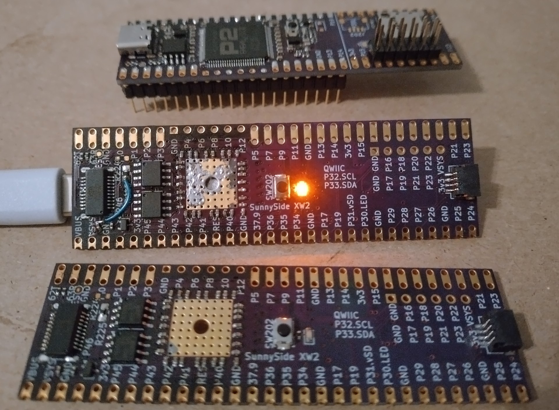

As there are no more castellated pins on the left side of the board, maybe you could change the double pin io ports to single ones to gain a bit more room on the board? Might give space for a full sized prop plug header or a led or dip switch?
Going to single pins would break compatibility with Pi Pico accessories. If the design works out I plan to squish it back down.
Do you really want a prop plug connector or would on board USB to serial work? I was able to fit an FT231 on board. I'll see how it works when I build it. I really like a board with a single USB connector for power and data.
The board has one LED, connected to P30. It will have a reset button like the teensy series.
Do you care about the color? I will probably order these in purple. But I could also get red cheaply. Green is of course an option, but this would have to be imported for the price I'm willing to pay.
Are you going to do anything critical with the ADCs? There are no LDOs here like the edge has. I don't consider this a big deal as the Pico doesn't have any LDOs either.
Saucy, if you don't have the means to bring out all of the pins, then overlay groups of 8 together (ie P0&P8, P1&P9, P2&P10, ...). This will allow you to add really nice monitoring capabilites, like logic analyzer and SCOPE ADC w/triggering. I wish I had made the silicon more like this, because it would have been nice to standardize diagnostics.

Board is in production. Time to order the parts. #4 is the only one that affects my ordering. The big decision is #5.

Already found a design flaw. Background: I have an old prop plug that seems to draw just enough power from the serial pins to trigger a reset pulse. The new prop plug has logic chips to block this current flow. Space is tight here so I want to do it with as few parts as possible. I thought I had a clever idea: just power the FT231 from VSYS instead of VBUS. If it has a good power source it shouldn't generate reset pulses. Unfortunately this limits VSYS to 5.5v. The regulators I chose are good for 17v.
But the FT231 has a option to run on 3.3v. I could cut the trace supplying 5v power and put a jumper wire in to supply 3.3v. edit: This also solves the lack of a nearby bypass capacitor for the 5v.
Another option would be to keep the 5.5v limitation and use the FT231 3.3v LDO to feed a bank of pins for cleaner analog. This would require changes to the board and would not be possible to do with jumper wires. But long term, I want to eliminate the FT231.

I have built 1 board. The on-board programmer works. It's immune the PLL noise issue when toggling p28-31. SD card works super fast, 27MB/sec. PSRAM works at clk/3, not terrible, not great.

I think the downloaders have been optimised early on for Eval boards, which uses the FT323 direct drive (non-inverted) wiring. And later boards using the Propplug became second citizens. Edge Cards have probably had oddball download issues all along.
I have a number of boards that (under Linux with loadp2) reset when the port is closed. IIRC there's a Linux kernel issue where the flow control signals change when the port is closed that doesn't exist on WinNT (this has been discussed before!). I'd have to dig them all out again to test, but IIRC the EVAL is one of the few that works correctly.
Thank You for this info! For this board I copied the rev E prop plug circuit. I use loadp2 on Linux. Programs do not run unless I enable terminal mode. The board resets immediately when I close the terminal.
It's a trade-off. With the prop-plug design the reset happens when closing the terminal. With the eval design the reset happens when opening the terminal. I think it could be useful to be able to open the terminal and Maybe the optimal solution is a filter that resets the chip only if there are 2 edges in a short time.

Interesting, can you test with Spin Tools IDE ?
Ah, nevermind, I found that I have a udev rule that prevents the reset on port close:
-hupcl disable the "hangup" signal when the last program closes the tty, without that rule the Propeller resets on port close also with the previous prop-plugs.

Top board is mine. It's fairly well tested. The downward headers are Pico configuration and the upward header is an EVAL connector.
Middle board works. Awaiting headers.
Bottom board mostly complete. It needs a P2, jumper wire, and headers.
