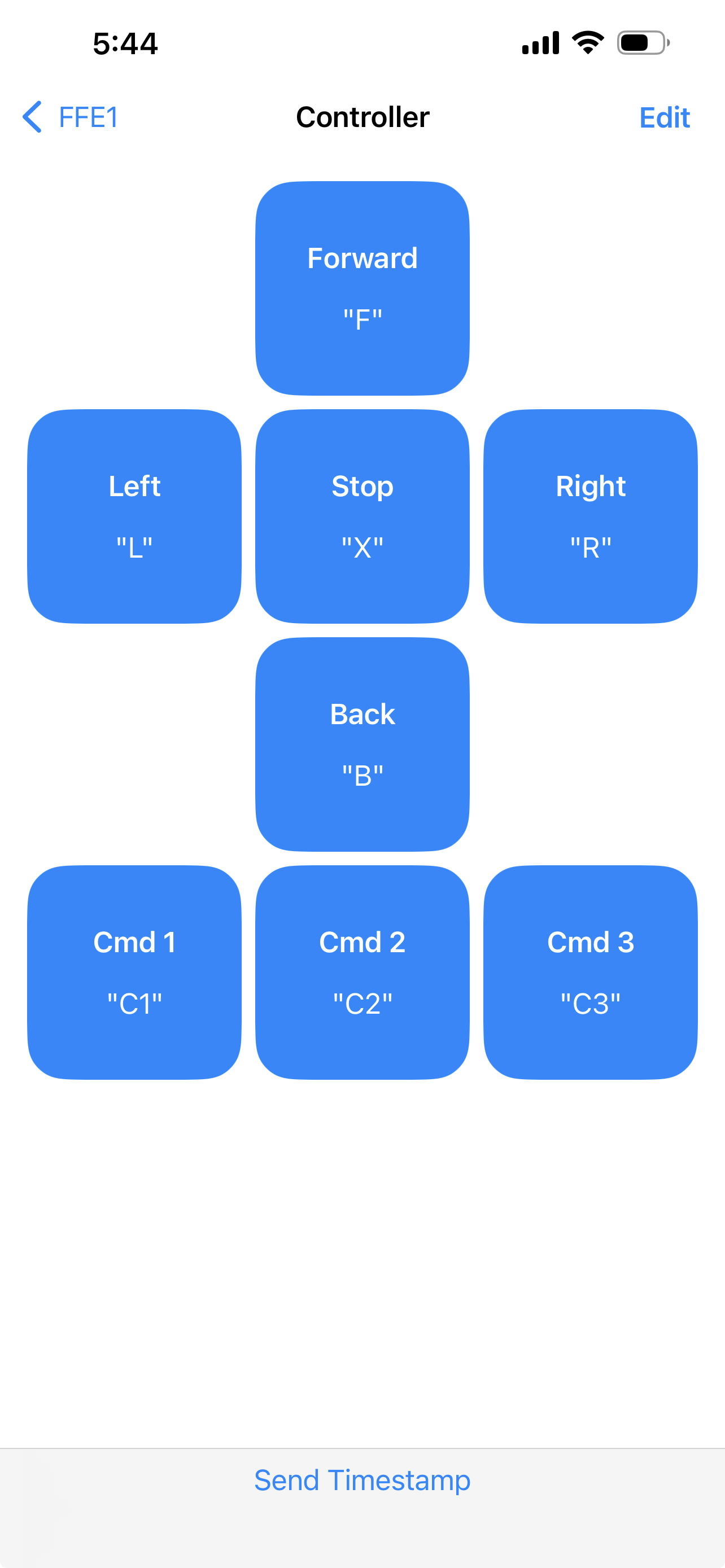

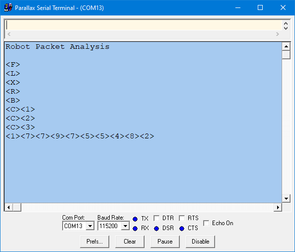

    I really need to read reviews before paying for for unknown things from the AppStore. I found a little app called Bluetooth Terminal from Lukas Pistrol. It has a configurable 12-key pad -- for $6. I did it. It's not too hard to set up, though not very sexy. Note you can hide unused keys (I did; see image). I'm not sure it's worth the $6, but it does seem to work. Here's the output from my customized keypad using the attached program. It's setup to show one packet at a time. The last line is the timestamp, but I don't know how that's evaluated.

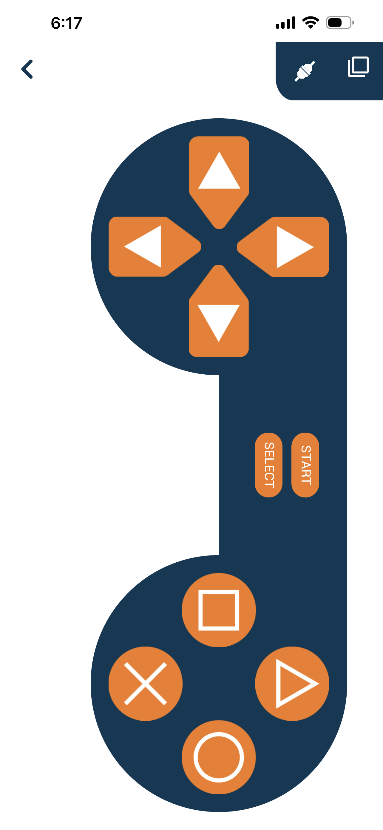

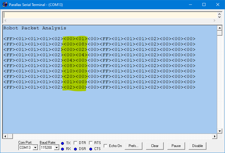

    The AppStore recommended a program called Dabble that is supposed to work with HM-10s and ESP32s. It's free, and the Gamepad does work. It's sends out a lot of characters, but they seem be of fixed length -- at least in digital mode. Here's a capture of the gamepad buttons.
    Up        <FF><01><01><01><02><00><01><00><FF><01><01><01><02><00><00><00>
    Right     <FF><01><01><01><02><00><08><00><FF><01><01><01><02><00><00><00>
    Down      <FF><01><01><01><02><00><02><00><FF><01><01><01><02><00><00><00>
    Left      <FF><01><01><01><02><00><04><00><FF><01><01><01><02><00><00><00>
    Triangle  <FF><01><01><01><02><04><00><00><FF><01><01><01><02><00><00><00>
    Circle    <FF><01><01><01><02><08><00><00><FF><01><01><01><02><00><00><00>
    Cross X   <FF><01><01><01><02><10><00><00><FF><01><01><01><02><00><00><00>
    Square    <FF><01><01><01><02><20><00><00><FF><01><01><01><02><00><00><00>
    Start     <FF><01><01><01><02><01><00><00><FF><01><01><01><02><00><00><00>
    Select    <FF><01><01><01><02><02><00><00><FF><01><01><01><02><00><00><00>
    The analog mode spat out a lot more bytes, as did the accelerometer mode.
    There are aspects of this program that seem to need an ESP32 with specific code running it it. So far, this seems to be the best of the apps I looked at over the last hour.
