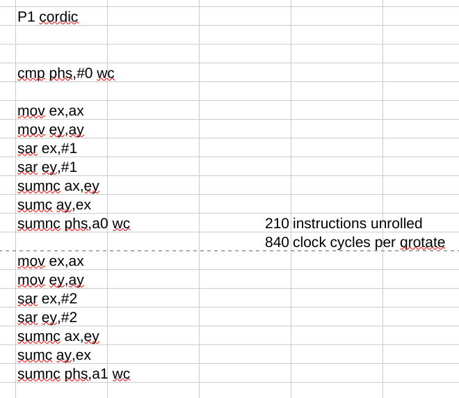

I thought maybe I could put my LameStation to work for a spectrum analysis project. Would just need an FFT for P1.
PASM2 isn't that different from PASM, we just need to replace the CORDIC. How about with a software CORDIC? After 31 cordic stages the shifted terms will round to zero, as well as the angle.
I think it can be done in 7 instructions per stage if unrolled. The P1 will take about 210 instructions or 840 clocks to replicate QROTATE without any scaling. I figured I could just use unscaled cordic operations and scale it all at the end.
A QROTATE needs 8 clock cycles on the P2, if there is enough other work to fill the latency. P2 is 100x+ faster on a per cycle basis. With P2's higher clock rate it's 200-400x faster. So depending on the instruction mix the P1 FFT would be somewhere between 4 and 200 times slower. Thus a 1024 FFT could take as long as 176mS.

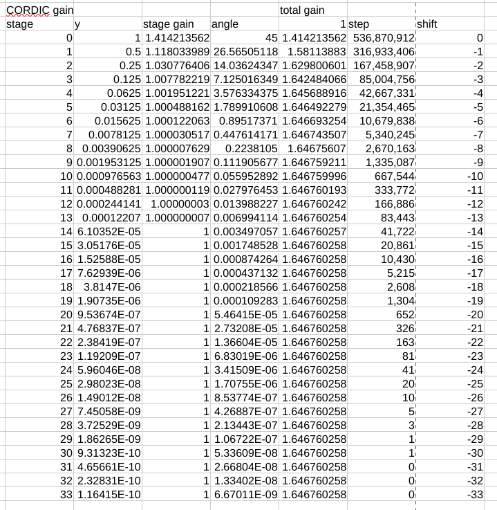

Heater's FFT takes 25mS. https://forums.parallax.com/discussion/128292/heaters-fast-fourier-transform I'm glad I searched before writing any code.
In Chips speech synthesis for P1 he used a software cordic with very carefully chosen number of bits resolution.
