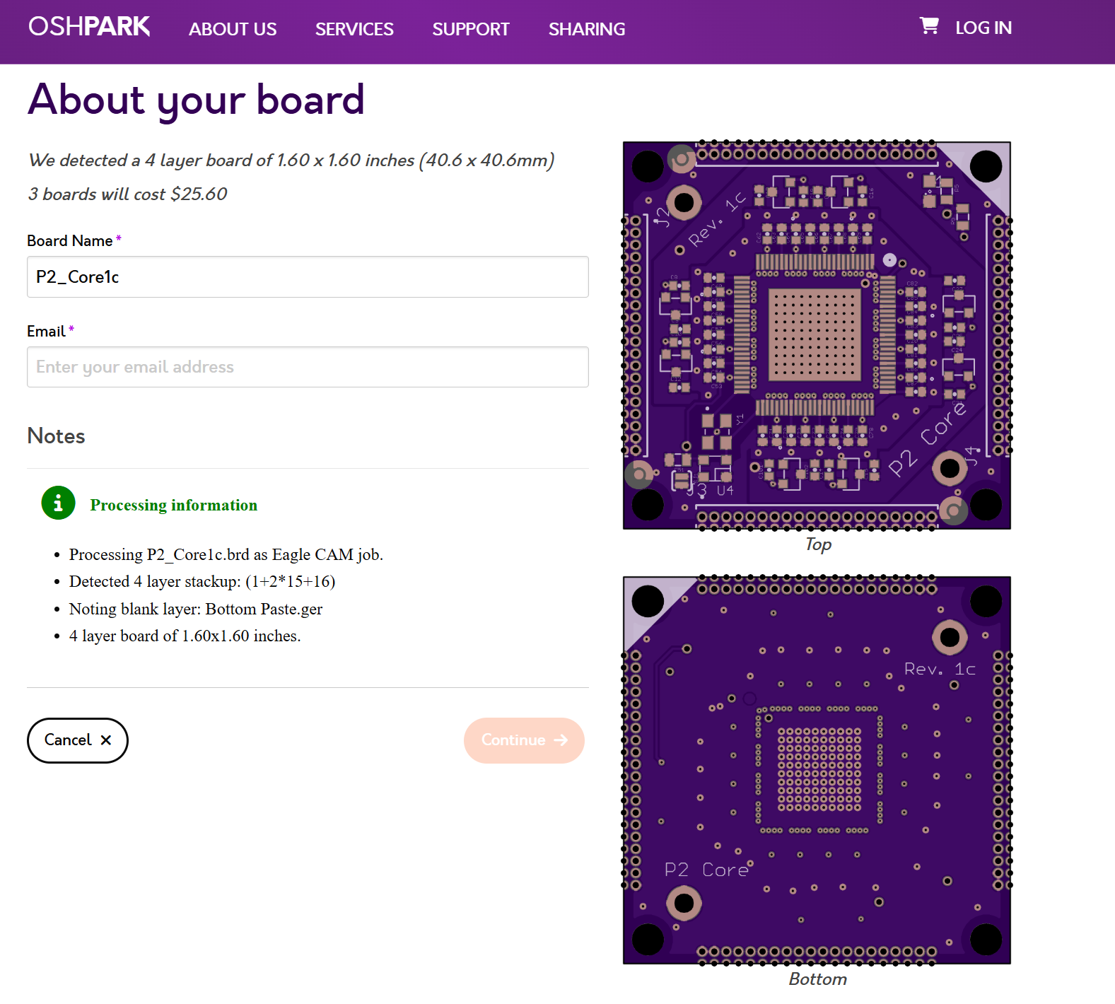

    I'm suddenly a big fan of OshPark for PCBs. Think going to order this thing today...
    Really like that it can directly accept Eagle PCB files and figure everything out.
    This is the first web thing that actually works fully with my Eagle pcb designs...
    Plus, price and speed are great.
    Purple is the only problem...

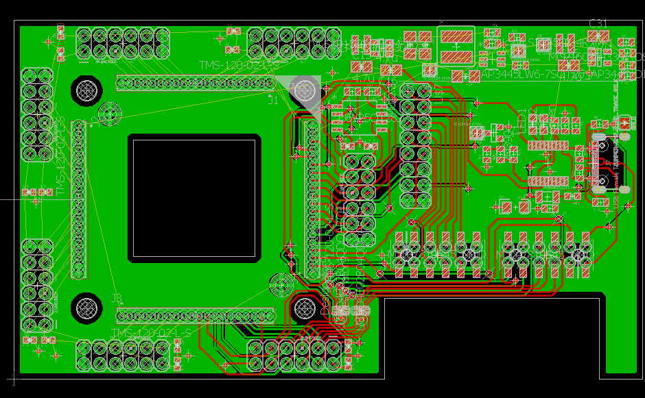

    Here's the first design that uses the P2 Core. It is a revised version of P2 PLC in DMB-4773 case. This will be the middle board.
    In the middle of laying it out now. This is a 2-layer board that has some significant layout challenges, but think past that now.
    Anyway, odds are that this first version is not going to 100% perfect and I'll have to do a revision.
    In that case, just pop off the P2 Core and put in the next. Saving P2's from the trash!

    One design decision that might be questioning is not bringing out the 3.3V VIO...
    This module has 3.65 VDC (regulated to 3.3 VDC for VIO) and 1.8 VDC (for core, may be boosted for overclocking) as inputs.
    There is no 3.3 VDC output.
    But, I'm copying the P2 Eval headers here in 6 places that needs 3.3 VDC.
    Not really an issue, just dropping in a small 3.3 VDC regulator, fed by VIO, to get the 3.3 VDC for the headers.
    Something new, but not expecting any trouble...
  • RaymanRayman Posts: 16,427
    Putting a large cutout under the P2 in the above layout to aid in airflow for thermal reasons.
    But, you probably don't really need this unless overclocking.
    Not having it would allow one to put many components under the P2 Core module to save board space...

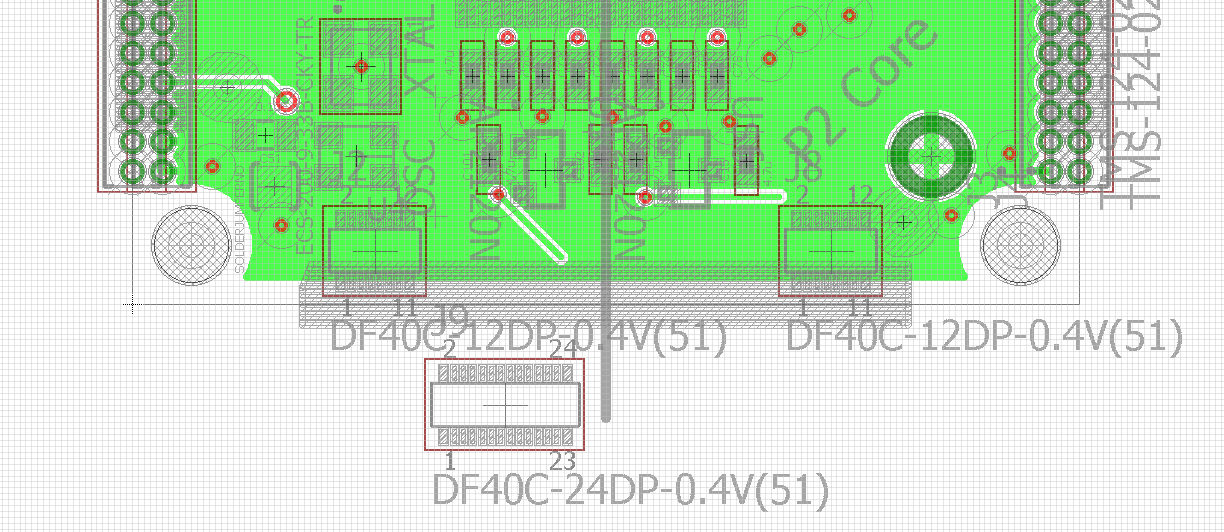

    Thinking about switching from 0.05" headers to high density connectors... Could use either one 24-pin or two 12-pin on each edge... Leaning towards two 12-pin just because easier to route and maybe more stable physically, although this doubles the price... Think still price competitive with 0.05" headers and a LOT easier to install...
    Plus, looks more modern....
