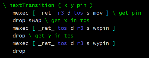

    Probably the combination with SPIN2 will be the most common. @JonnyMac 's Nuts and Volts text could be linked.
    If MicroPython will support more than one Cog in future, than the combination of inline assembler with that will make sense.
    "Minefield". This is, how inline single assembler instructions mixed with Forth look like in P2XCForth:
    It's fast :)
    Hmmm. I have no idea what that is, but it is certainly not assembler as most people would expect to see it.
