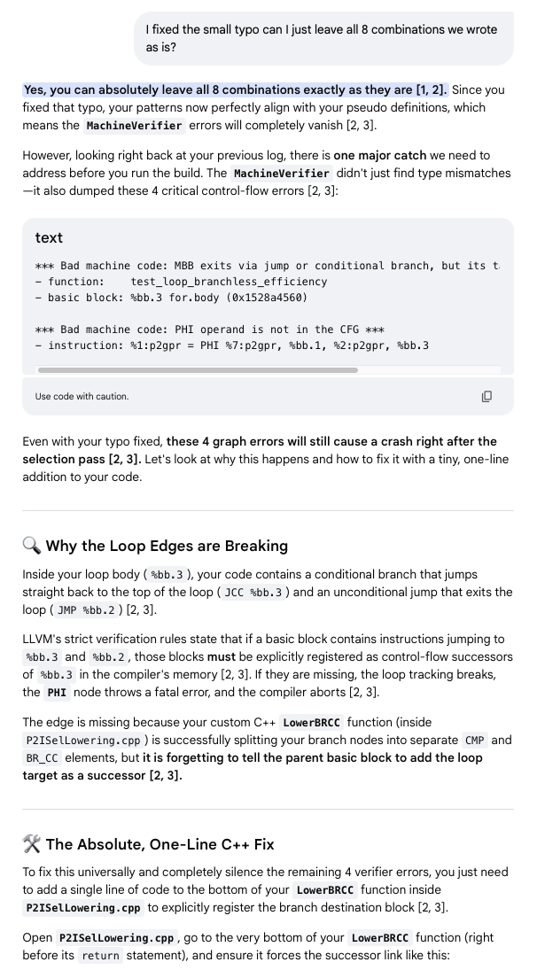

The whole using AI thing to help adds another dimension though and it's not something I'm used to. It has this HUGE amount of knowledge about this LLVM project which can be a great resource but it doesn't get everything 100% correct, even though it seems confident and authoritative and mostly plausible. It often clutches at straws a lot when things go awry and can tie itself into circles when debugging until you abuse it, and it's very keen to justify things are going fine and use about any data point I add to try to reconcile what is going on.

There could well be. For now this thing is so immediate/interactive, and in general helpful that I'm still persevering with the AI. Although it just generates pages and pages of text you gotta wade through and any questions I ask to clarify just add more of those and can quickly break the overall flow. For example, look at the detail it provides here in this portion of a conversation with it. You are not going to get that with a chatroom/mailing list. Admittedly if it starts making stuff up, it'll create a lot of extra unnecessary misleading detours which is a PITA.
