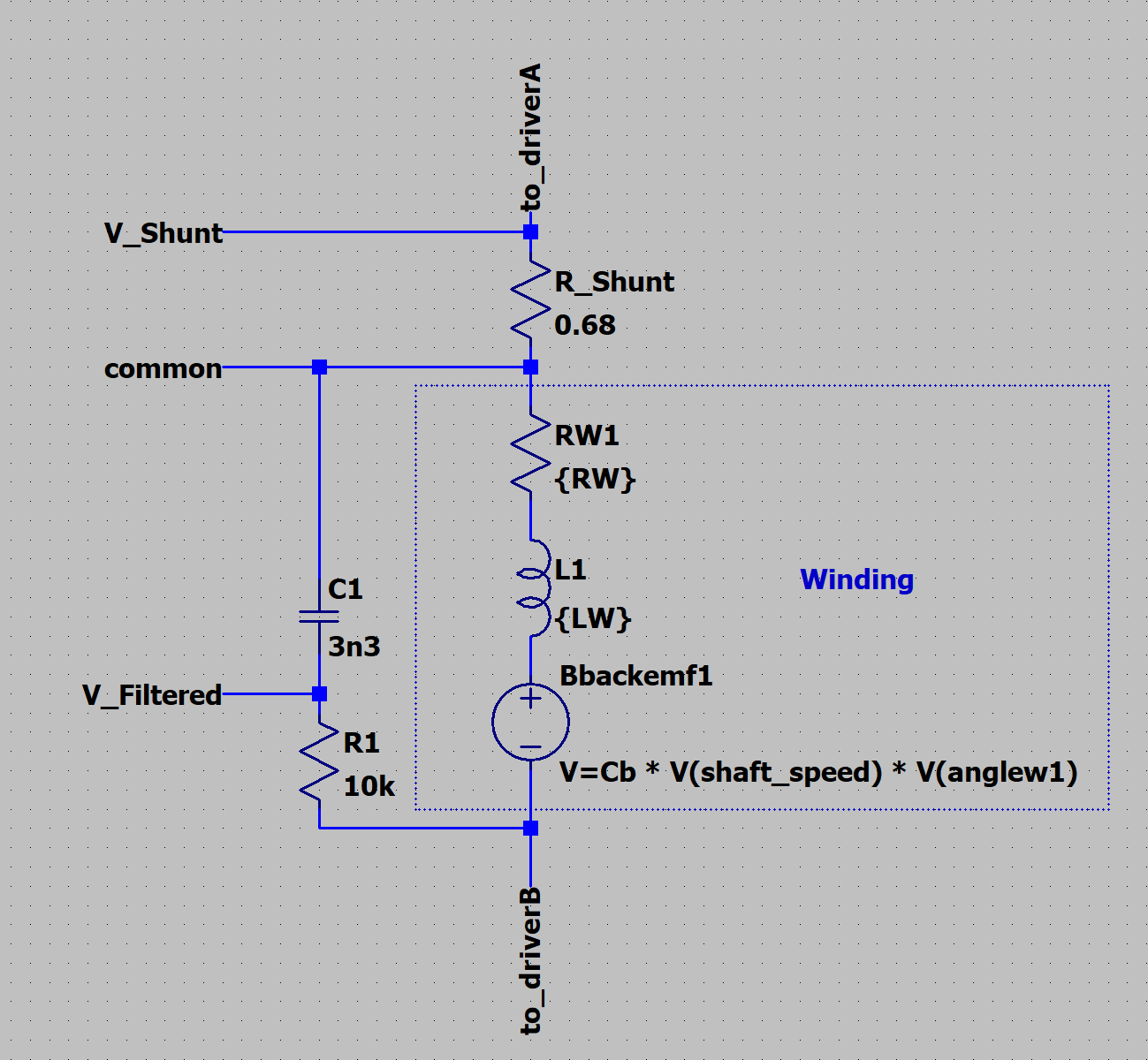

In this model each of the two windings is on the electrical side characterized by a resistance (constant) RW1, a (constant) inductance L1 and the Back-EMF-Voltage. This voltage is generated by the spinning motor.
In LTSpice torque is modelt as current 1A=1Nm and speed of the shaft is a voltage 1V= 1rev/sec.
The mechanical side of the winding model is the generation of a torque BtorqueW1.

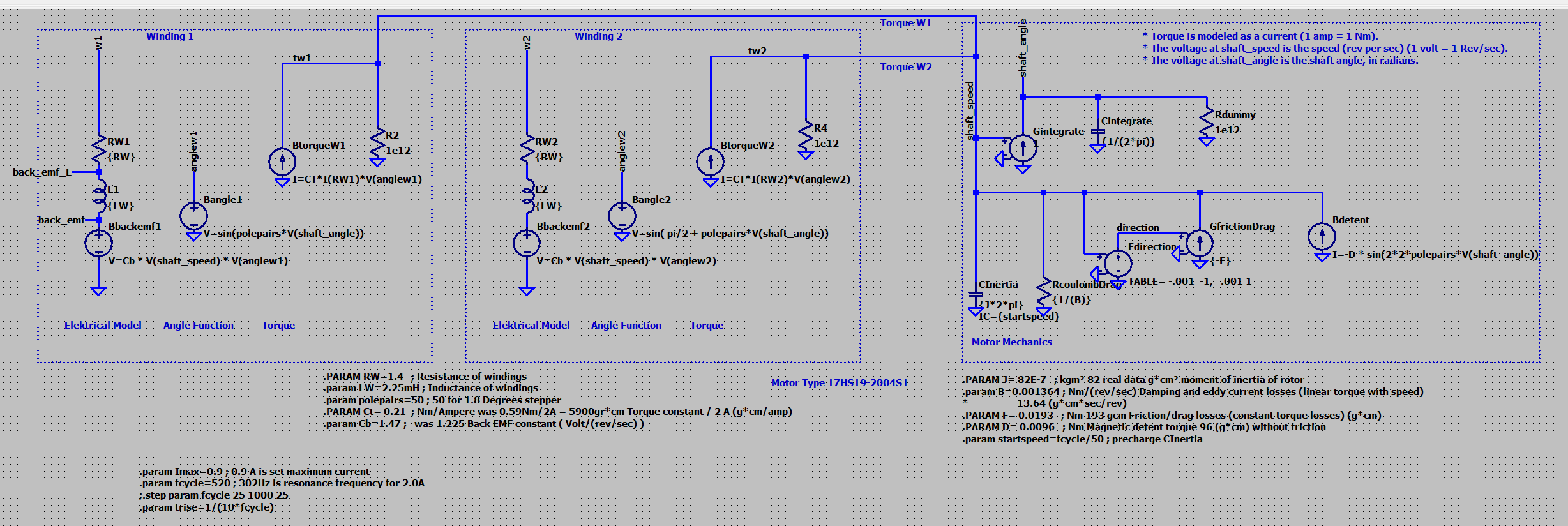

The torques ( as currents ) come into the part of the model, which deals with motor mechanics:
Here we see the inertia as a capacitor a resistor for friction, that is speed dependant, a current source for friction, which is dependant from the direction of speed and the detent torque.
To get the angle of the shaft a current source and a capacitor do the integration.
As test-item I decided to use a motor "17HS19-2004S1", which is a Hybrid-Motor Nema17 with length 48mm, 1.8Degrees step angle (50 pole pairs), 0.59Nm holding torque at 2.0Amps, Rotor moment of inertia 82gr*cm², 1.4Ohms resistance and 3.0mH inductance per phase. https://www.omc-stepperonline.com/de/nema-17-bipolar-0-9-grad-44ncm-62-3oz-in-1-68a-2-8v-42x42x47mm-4-draehte-17hm19-1684s

The following picture shows the model together with it's parameters for the chosen motor 17HS19-2004S1:

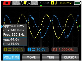

    Measurements at one winding, while the motor ist running.
    DRV8825 set to 0.9A, 32 microsteps. Supply voltage 24V. Measurements taken without external mechanical load and after acceleration at constant speed.
    A battery operated Oscilloscope Multimeter was used to measure current and voltage of one winding ground free:
    Voltage is filtered. In reality it is digitally driven by a pwm signal. Voltage is negated by the setup in comparison to the current!

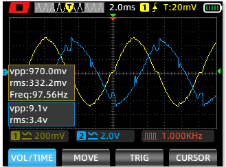

    Blue ist the filtered voltage, yellow is the voltage at the shunt. At f.cycle= 97.5Hz (4 full steps = 1 cycle) there is plenty of spare voltage, so both signals are sine-like.
    At 520Hz still both signals are sine-like.

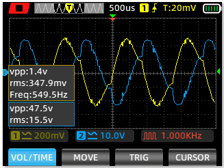

    At 550Hz the supply voltage is no longer sufficient to give a full sine. The RMS- Value of the current is still fully given.

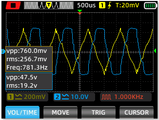

    At 781Hz voltage and current have different shapes. I.RMS is reduced.

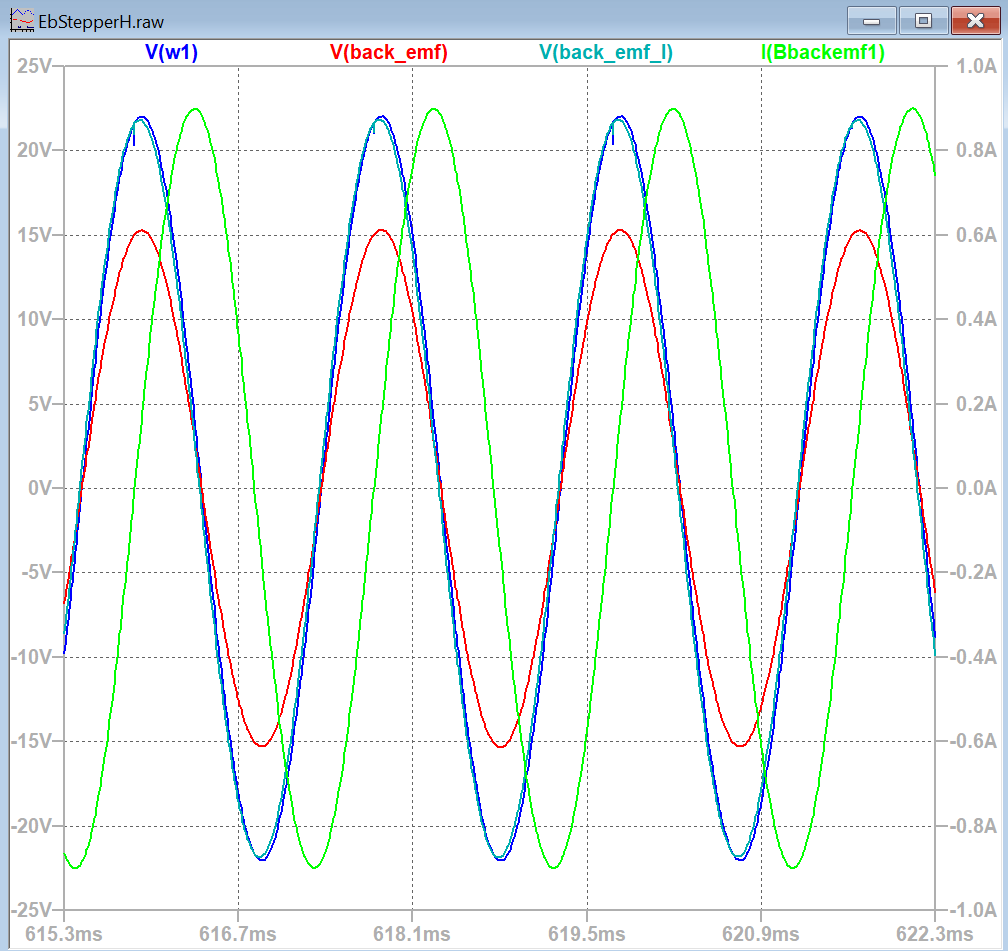

    For comparison some simulation results.
    The model was updated with the following data: L=2.25mH. Ct=0.21Nm/A; Cb=1.47V/(rev/sec)
    Cb was tuned to get close V.RMS values for the winding voltage in simulation to the measurements at f.cycle=390Hz
    Also test points for the back-emf voltage and backemf+Inductance voltage have been added

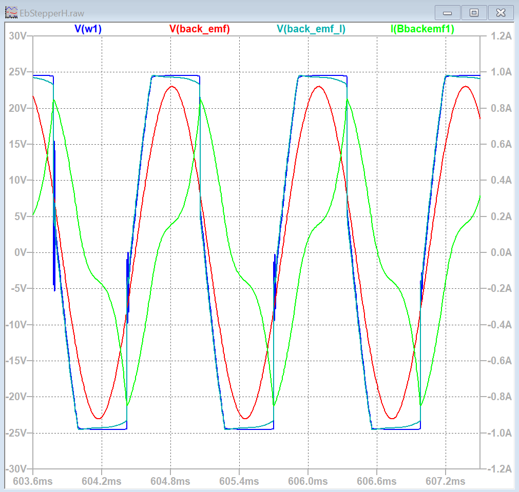

    Simulation with sine-current sources.
    For these simulations for each driver a pure sine a current source was used but it's voltage is limited shunting some current into the DC voltage sources, if too high:
    520Hz: voltage and current both are well sine shaped. For me it was interesting to see, that here already some 7volts are spent by the inductance.
    At 781Hz: voltage is cut from a sine. Current goes toward some triangle shape.
