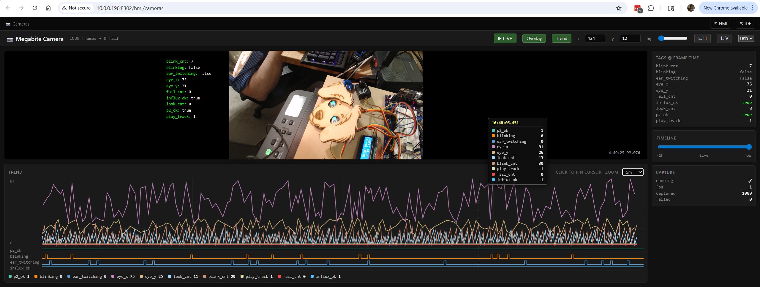

    Well one cool thing is you can just ask the built in AI to generate an HTML screen linked to your ST code (which btw is linked to the P2 Megabite demo in this case). I'm even looking at seeing if anyone in tech schools or colleges are interested in using it to teach PLC programming, since most are teaching ladder, which is not what your cutting edge PLC manufacturers are focusing on for motion control and such. You could theoretically just have it generate whatever screens you need and it can link them to your variables and such.
    Here is a couple screenshots. One was the Megabite demo as a HMI which was neat. Took maybe a minute to generate? The animated eye movement was wild.

  • Here is a screenshot of the time machine SCADA hmi featuring the P2 Edge running Megabite.
  • Video of it: (better view of the P2 Edge hardware I'm using)
    https://youtu.be/5SfmOjAwyMk
