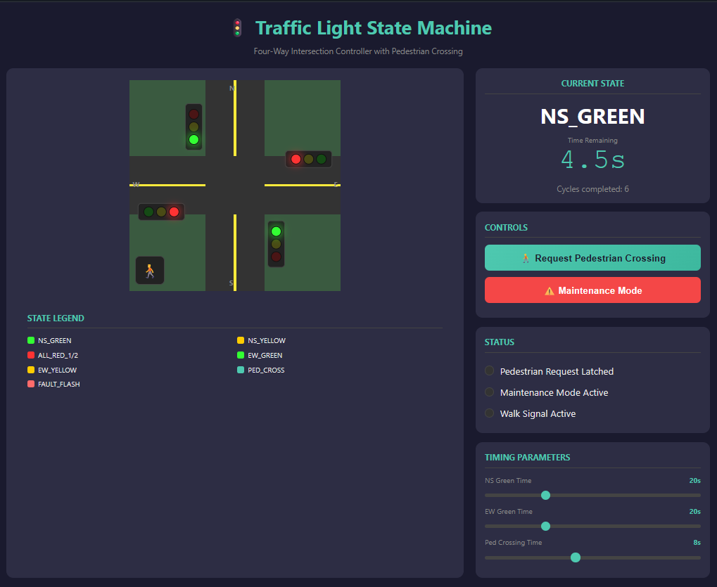

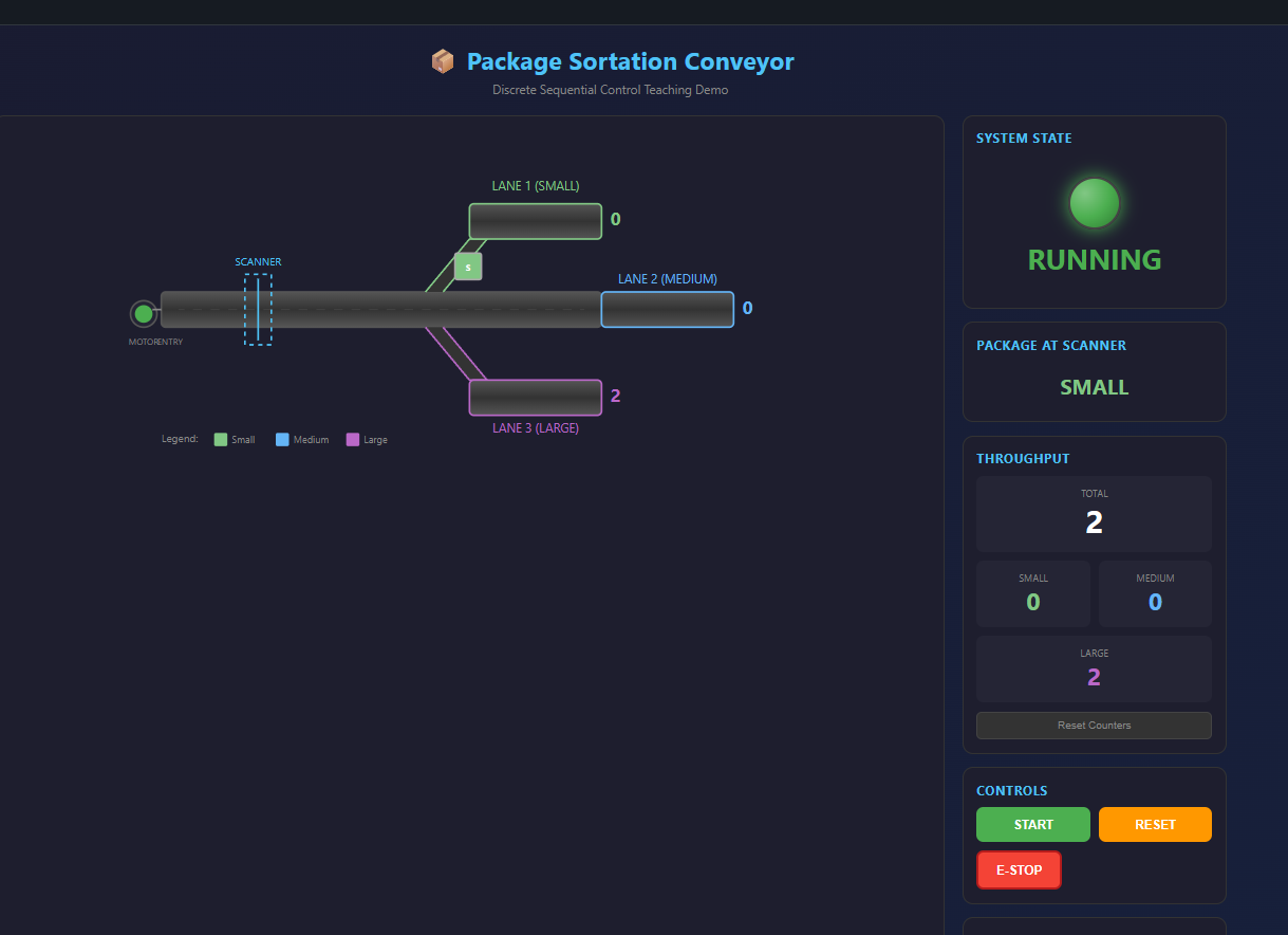

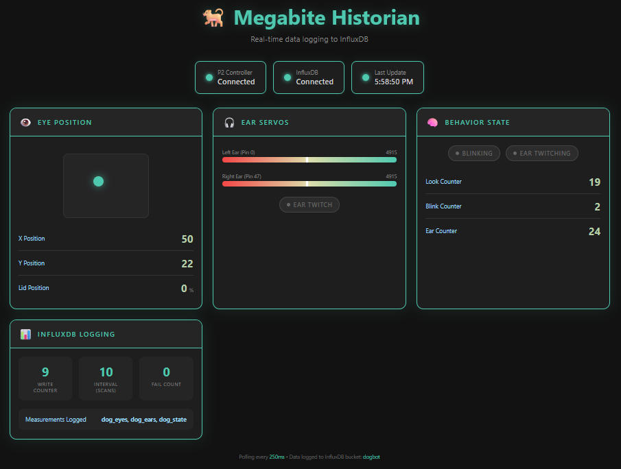

    Well one cool thing is you can just ask the built in AI to generate an HTML screen linked to your ST code (which btw is linked to the P2 Megabite demo in this case). I'm even looking at seeing if anyone in tech schools or colleges are interested in using it to teach PLC programming, since most are teaching ladder, which is not what your cutting edge PLC manufacturers are focusing on for motion control and such. You could theoretically just have it generate whatever screens you need and it can link them to your variables and such.
    Here is a couple screenshots. One was the Megabite demo as a HMI which was neat. Took maybe a minute to generate? The animated eye movement was wild.
    More on the Megabite HMI:
    https://youtu.be/weUMdsgLB6o
    This was for a couple teaching demos I generated. each took maybe 2 minutes each - ST code, HMI, testing, Lesson.
    First a conveyor system:
    Second, a traffic light system:
    BTW I added the P1 FLIP, that worked great. So for my hardware test - I have 3 Parallax boards plugged in via a Phidget 8/8/8 Hub I bought cheap on ebay. Each Parallax is autorecognized and autodownloaded and running in under 5 seconds. I even have an Arduino Unu R4 (gasp!) plugged in also that auto starts also.
