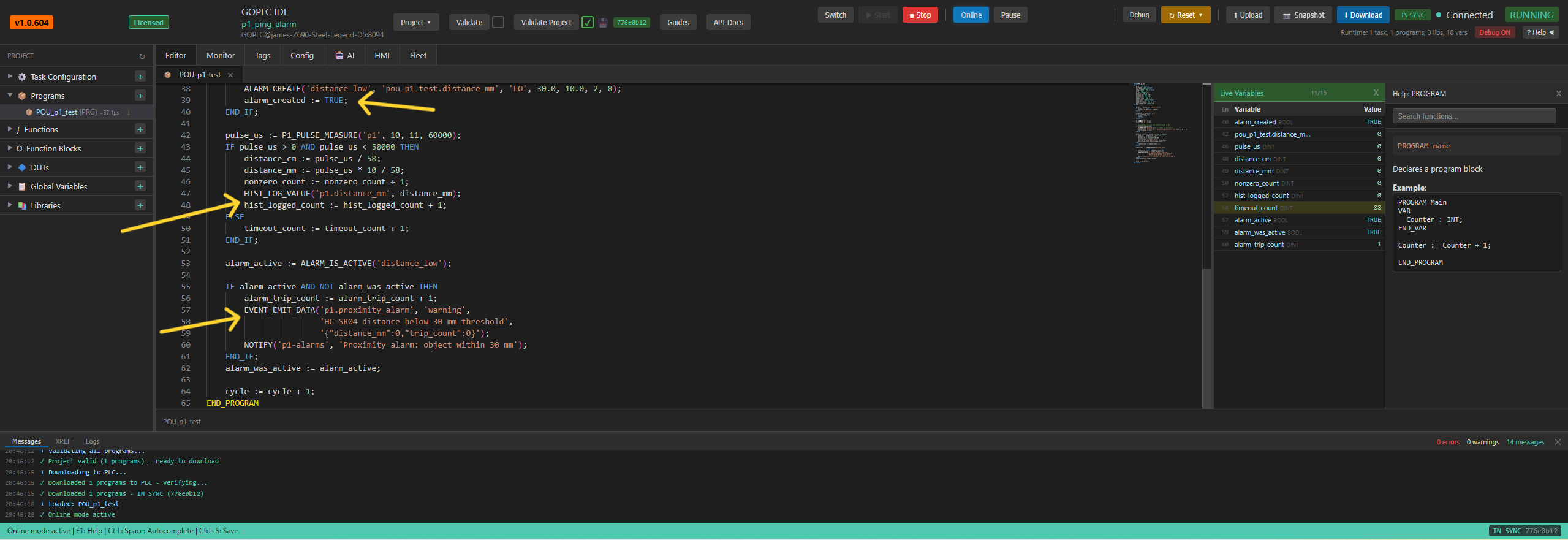

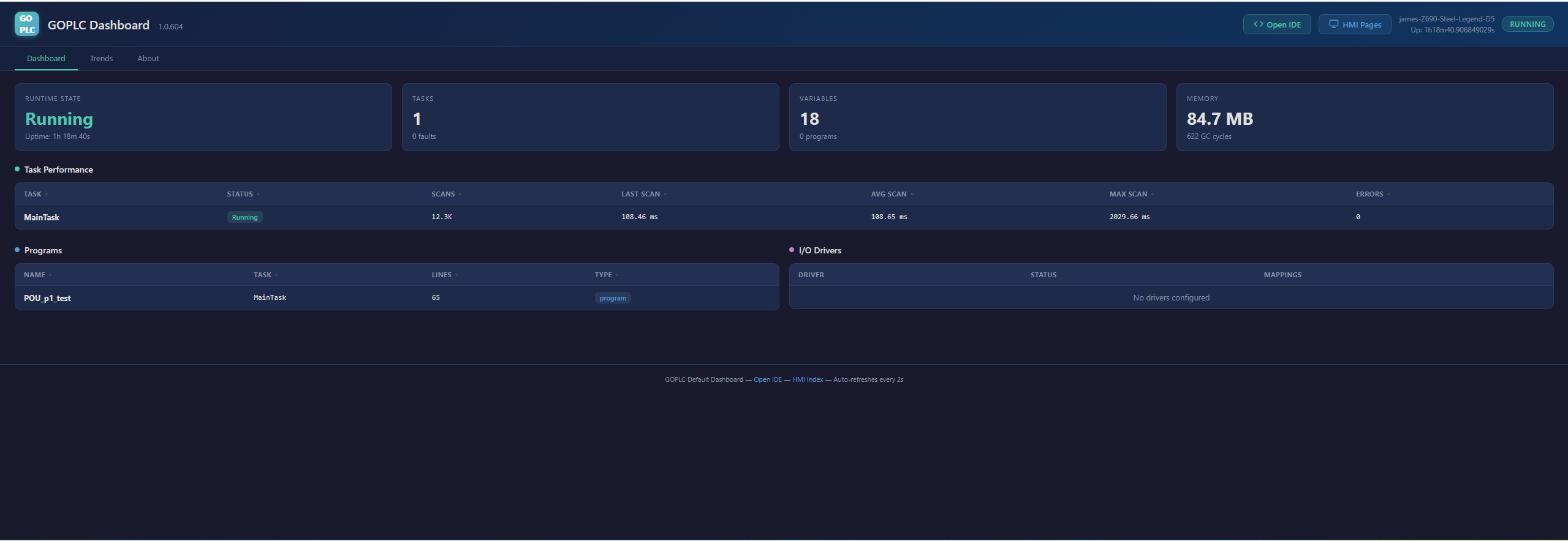

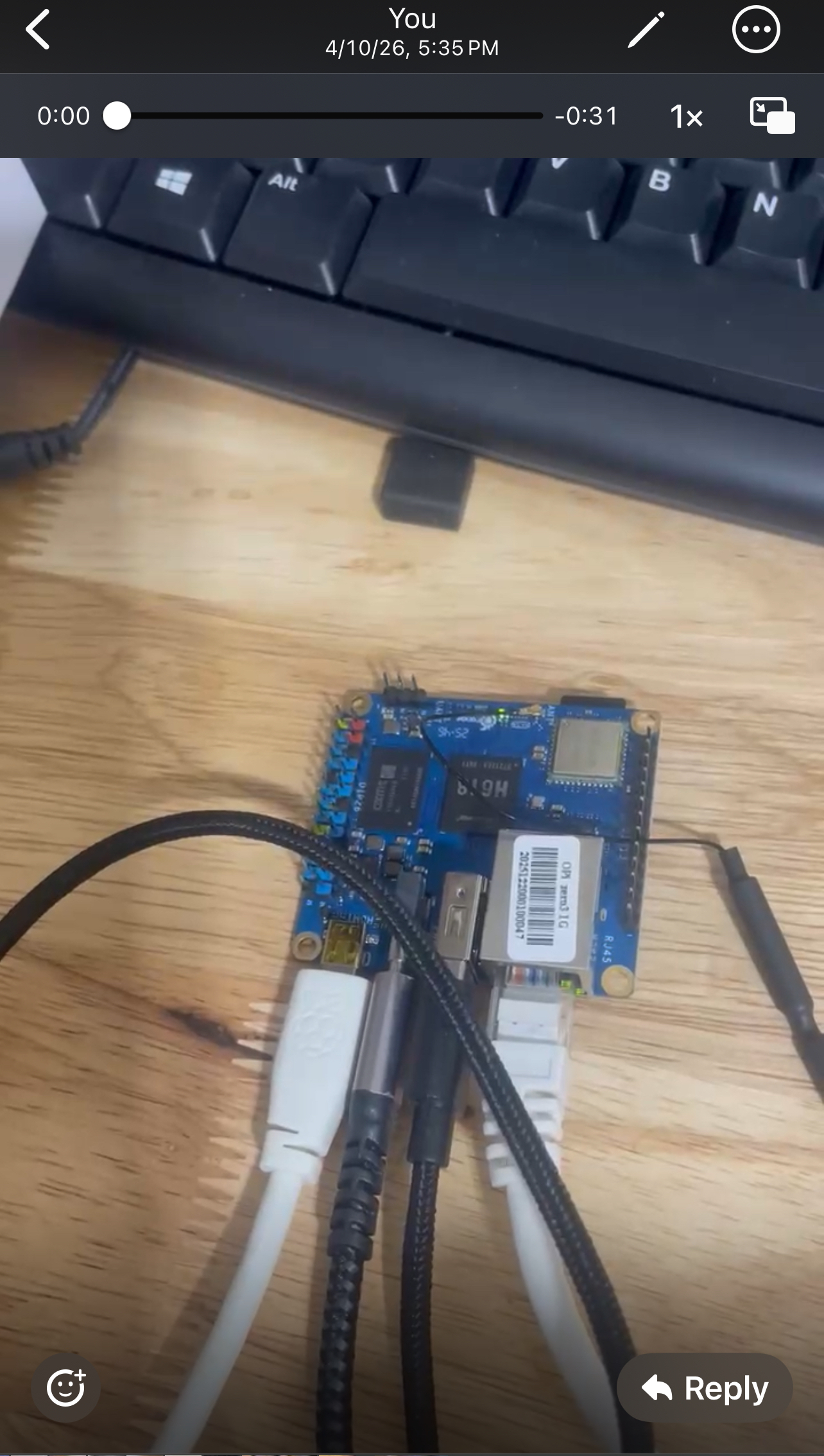

I got the P1 board running with GoPLC as another target. Its been a couple years since I've touched a P1 and I was able to get it going without much effort. Its very similar to the P2 interface just without the smartpins and other cool stuff the P2 has. As in the P2 version, I can take a brand new board with no code on it right out of the bag - plug it in, software downloads and starts running. GoPLC is hosting a blob binary for this one as well.
This testing was for the Alarming, Historian, and Webhook events integration. I had a Ping sensor being logged to the historian and had an Alarm to trigger when the sensor distance got too close, where it tripped the alarm and fired off the Webhook (which was an MQTT publish to a broker). Going to buy some FLIP modules now probably. I also ran it on a $23 Orange Pi Zero 3W SBC (1MB ram and im only at about 90MB). Right at 110ms scan, with a 2000ms startup downloading the firmware the first time.
