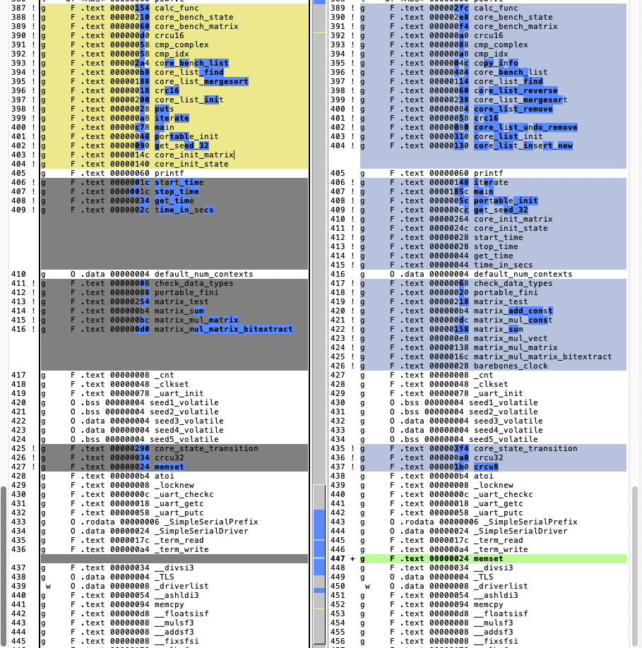

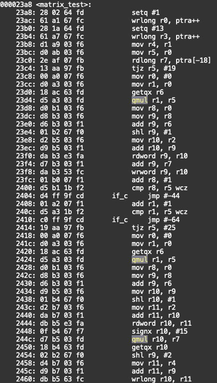

    Found one suspicious thing in the LLVM optimized code. This CoreMark bug may relate to the CORDIC QMUL. For some reason in this optimized code snippet, it is potentially executing a GETQX before a QMUL operation. This doesn't look right to me unless its trying to flush the CORDIC somehow first, but that is seemlingly not ever done in the unoptimized code which always puts the QMUL before the GETQX unless it needs to directly feed the next QMUL from a prior CORDIC result, which doesn't appear to be happening here in this case.
    Perhaps LLVM code generator needs to be somehow told to not reorder CORDIC instruction pairs/groups like "QMUL" followed by "GETQX/Y" if that is not already done, as perhaps it's trying to pipeline it somehow and it's going awry. The CoreMark matrix multiply operation is definitely wrong when I print out the resulting matrix values and compare with flexspin's results, and its CRC obviously fails then too.
    Tagging @n_ermosh as well in case it helps.
    EDIT: I'm guessing this might be happening because if you do something like:
     QMUL r1, r2
     GETQX r3
    then the compiler's optimizer thinks it could reorder the instruction affecting the r3 destination register independently because it doesn't know it actually (indirectly) still depends on r1 & r2 from the QMUL. Maybe that needs to be somehow specified in the instruction definitions if it's not already being done.

  • roglohrogloh Posts: 6,389
    edited 2026-03-21 21:04
    Sure enough, the last thing I found that stops the CoreMark benchmark program from matching the CRC seems to be another GETQX before QMUL instruction case. Once I include the (currently commented out) printf to the matrix_sum function it affects the optimizations for the code and the problem goes away.
    Here's the code (left side is with the bad optimization, right side is with the printf restricting the optimizer from reordering, and thereby making it work). Look what it did to the QMUL & GETQX in each case. Its a complete order reversal in the failing case. Haven't proven it but the optimized code may potentially work if it didn't get that wrong.
    EDIT: tried patching the CORDIC instruction order in the intermediate .s files generated after optimization and then sending those patched files into the assembler for relinking but it appears that P2LLVM doesn't like working with its own assembly file output format. Seeing lots of these errors on the patched files:

    Feeling kinda pleased rn.
    With some luck and a little effort I think I was able to modify the table definitions in the P2LLVM code to update the templates for CORDIC instructions that implicitly affect the QX/QY "registers" on a P2. It seems that now with -O1 optimizer setting applied when building CoreMark code all the GETQX and GETQY follow immediately after the QMUL or QDIV operations and are no longer being placed before them when I checked the disassembled output. This now lets CoreMark built with P2LLVM complete with the same good CRC results as when built by flexspin. I did notice that performance dropped a bit from before - probably because of the extra CORDIC wait time now after the multiplication or division until the result is ready before continuing. It now gets 41 CoreMark iterations/second under LLVM instead of 50. To hit close to 50 again it would probably need some really good CORDIC pipelining and the optimizer is not setup for that AFAIK.
    Left is the flexspin built CoreMark result, right is LLVM built result
    In case you want to review and/or apply them to your code @n_ermosh , here are the changes I put in for the CORDIC dependencies on QX/QY. It appears you just need to setup the "Defs" list to include any other unspecified registers that are affected by an instruction. I just passed QX and optionally QY as well for the CORDIC instructions that modify them.

    Now that I have P2LLVM sort of working I was looking at the PASM2 instruction frequency distribution of the reasonably large (over 300kB) LVGL project I just built with it, to see the range of P2 instructions it generates.
    With P2LLVM some of the CRT and C library code gets loaded into COG and LUT, and main starts at $a00 in HUBRAM which then includes the remainder of the C library that doesn't fit the LUT, so I've split the frequency distribution into two, one for COG/LUT use vs the other for HUBRAM use. Here's the breakdown of how many instances of each instruction are used in each memory.

    What is interesting is that really the only "illegal" instructions my external memory caching scheme would not support from this HUBRAM group would be the "tjz" and "tjnz" cases which would break the caching, unless handled differently. If I can modify these to do a AND reg, reg wz followed by if_(n)z JMP #xx I may still be able to get my external memory solution working with this P2LLVM compiled code, assuming I can run my SED scripts on the resulting PASM2 output to convert the use of "CALLA" into "CALLPA ..." and do other branching cleanups etc.
    Even if P2LLVM's built in assembler can't currently re-assemble its own code due to cases of unsupported "PTRA[expr]" etc I'm thinking I may still be able to use either flexspin's own assembler or possibly try out Dave Hein's one to get the final output code created that could work with my external memory scheme. Given flexspin still assembles at addresses above $100000 (despite a warning) I might be best to start with that.
    Also I may be able to make use of LLVMs more capable linker scripts to reorder the code in memory so that I can place some functions in external memory and others into internal (HUB) memory via attributes or naming. This is potentially very handy and I now might have a way forward assuming P2LLVM code really runs okay. It certainly works with CoreMark but I probably should try to get some LVGL code running internally from HUB to prove that first. Will ultimately need to port my PSRAM driver API to use C as well, same for my video driver and use BLOBs for the PASM2 drivers unless I can integrate further with flexspin.
    EDIT: far out, just realized this may let native P2 MicroPython finally shine on the P2 if it can be rebuilt with P2LLVM instead of all those messy and nasty p2gcc workarounds I came up with way back when, but that's a different story and a yet another distraction from what I want to do right now. Don't tell Lachlan, LOL.

    • extract symbol table
    • locate addresses for missing labels in disassembled source of shared functions and prepend them to the original label so they will share the same code address when still referenced by callers
    • process the file and define r0-r31 register names from $1d0-$1ef as CONstants, add the ORG/ORGH & DAT lines and remove some unwanted P2LLVM formatting to keep flexspin happy
    • extract both data segments and their addresses (.rodata and .data) to files to be included in the final .p2asm file at their correct hub RAM address using ORGH and "file" commands
    • convert # constants for AUGS/AUGD use by shifting left by 9 bits
    • convert # constants in TJNZ/DJNZ/TJZ and relative JMP instructions in both COG/LUT and HUB sections into different expressions relative to $ as appropriate, as labels are not present to compute the offsets and flexspin still needs a way to compute its own relative offsets (also handle any negative values from $100-$1ff)
    • remove some extraneous "0x" hex prefixes in LLVM disassembled output
    The code section of the flexspin binary was diffed against the original code segment in the P2LLVM .elf file extracted by llvm-objcopy and found to be the same except for:
    • some CALLA instructions originally made to the duplicate function addresses - now that the labels are unique the callers all call the same code instead of their own private copy. This won't affect behaviour but I could potentially make them use the same call addresses as before if needed by using the unique label when I change it. Not really needed IMO.
    • Some WRLONG reg, ptra instructions were coded differently by each assembler. P2LLVM uses the write register format with "Imm" bit = 0, while flexspin uses the pointer indexing format with "Imm" bit = 1 and S = #$100 to reference PTRA[0] instead of the PTRA register. But they work the same so no big deal.
    The main takeaway here is that I can now potentially start to modify the disassembled code to try out my external memory scheme. I'll need to be careful with the code segment size increasing though as all data accesses are already hardcoded at fixed addresses and would be difficult to move after initial compilation. Also the branches are coded using fixed relative jump offsets - so I might need to get the script to generate labels for these relative jump targets so if code size adjusts the branches still work. This would be needed for example due to more AUGS/AUGD use for adding callpa ##extfuction, farcall to call functions located in high memory instead of the simpler CALLA instructions used right now. Will need to think about memory layouts in the linker script for the best way forward...
    I've only really started doing this as I found I can't use flexspin yet to compile more real C projects such as LVGL, the number of errors/warnings seen are still preventing me from doing that.
    Another possibility though with this is that this tool could probably let us generate binary blobs to be included in a flexspin image which can be loaded and run on self contained C cogs. This would be fully compiled for speed by P2LLVM but encapsulated by flexspin with it's own additional capabilities still available such as bundling it up with SPIN2 objects it can also spawn at run time. It could let us create executable C code "application bundles" that can be read in from external storage and executed on demand. Something like a prebuilt MicroPython "C object" would be useful with this idea too, or other tools, especially if it can work with external memory. The application bundle is basically self contained but if needed it could still work with mailbox addresses passed in at startup on its stack to make use of other capabilities provided by flexspin and other COGs (such a SD filesystem access/video/USB etc).
    I'll comment and tidy it up and post this script here soon. It is for a MAC so there may be some BSD/GNU differences in SED for example.

    Here's the shell script file I mentioned above in an attached zip archive. It's called convert-elf and gets passed the .elf file generated by P2LLVM toolchain and will generate a .p2asm file from the information within it.
    Before you can use it you may need to update the p2llvmpath variable in the script to point to your local p2llvm installation's bin folder unless that's already in your existing path. Also be sure to make the shell script executable with "chmod +x" if the unzipping tool you use loses the file attributes.
    This is the sequence I followed in my setup all the way from P2LLVM compilation and linking, to conversion, to assembling, to downloading via loadp2 and then execution on a P2:

    I've also included the custom 32 bit diff tool source I made which compares binary files as 32 bit quantities and will then print any different P2 hex opcode values found at their corresponding addresses. It's useful for verifying the code conversion works as expected. It just stops when it runs out of data in either input file.
    To make use of it after you compile diff32.c you first need to extract the original .text code segment as a binary file from the .elf file generated by P2LLVM and you can then diff32 this file against the corresponding binary image file that is output by flexspin. The following sequence shows how I used it to compare the opcodes from the original .elf file binary and the binary flexspin creates from the converted .p2asm file. You can see some of the (minor) code difference I mentioned earlier, but as mentioned the code still worked okay even with these differences.
    ❯ /Users/roger/Applications/p2llvm/bin/llvm-objcopy -j .text -O binary main.elf main.elf.text
    ❯ ./diff32 main.elf.binary main.elf.text > diffs
    ❯ for f (`cat diffs | cut -f1`) ; do
    grep "^0*$f " main.elf.lst | grep -v "  |"
    grep -m 1 "$f:" main.elf.p2asm.orig
    echo ""
    done
    00000 000 00 A1 07 FB |              rdlong r0, ptra
           0: f8 a1 03 fb            rdlong r0, ptra
    00040 010 00 A1 07 FB |              rdlong r0, ptra
          40: f8 a1 03 fb            rdlong r0, ptra
    00068 01a 00 A1 07 FB |              rdlong r0, ptra
          68: f8 a1 03 fb            rdlong r0, ptra
    00200 200 F8 76 C0 FD |              calla #\__addXf3__
         200: f8 6f c0 fd            calla #\__addXf3__
    002bc 22f 28 7D C0 FD |              calla #\__leXf2__
         2bc: 78 7a c0 fd            calla #\__leXf2__
    002c4 231 CC 7D C0 FD |              calla #\__geXf2__
         2c4: 9c 7b c0 fd            calla #\__geXf2__
    002cc 233 74 7E C0 FD |              calla #\__unordXf2__
         2cc: c4 7c c0 fd            calla #\__unordXf2__
