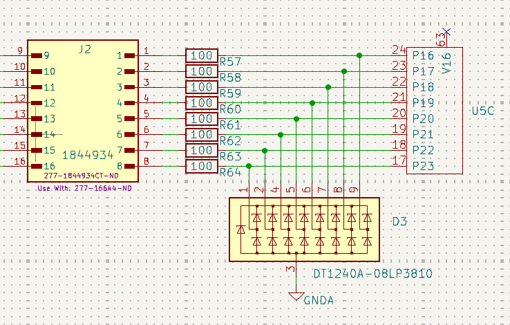

Series resistor with small capacitor bypass works for most human-body cases. I use a series resistor as a fuse with a zener bypass if I think something really nasty might happen. (24V to logic short..) or several resistors to build enough gap with capacitor and zener, maybe even a GDT if I think something 300 volt-ish or more might happen, but at that point it's more about avoiding fire than any kind of fault tolerance.

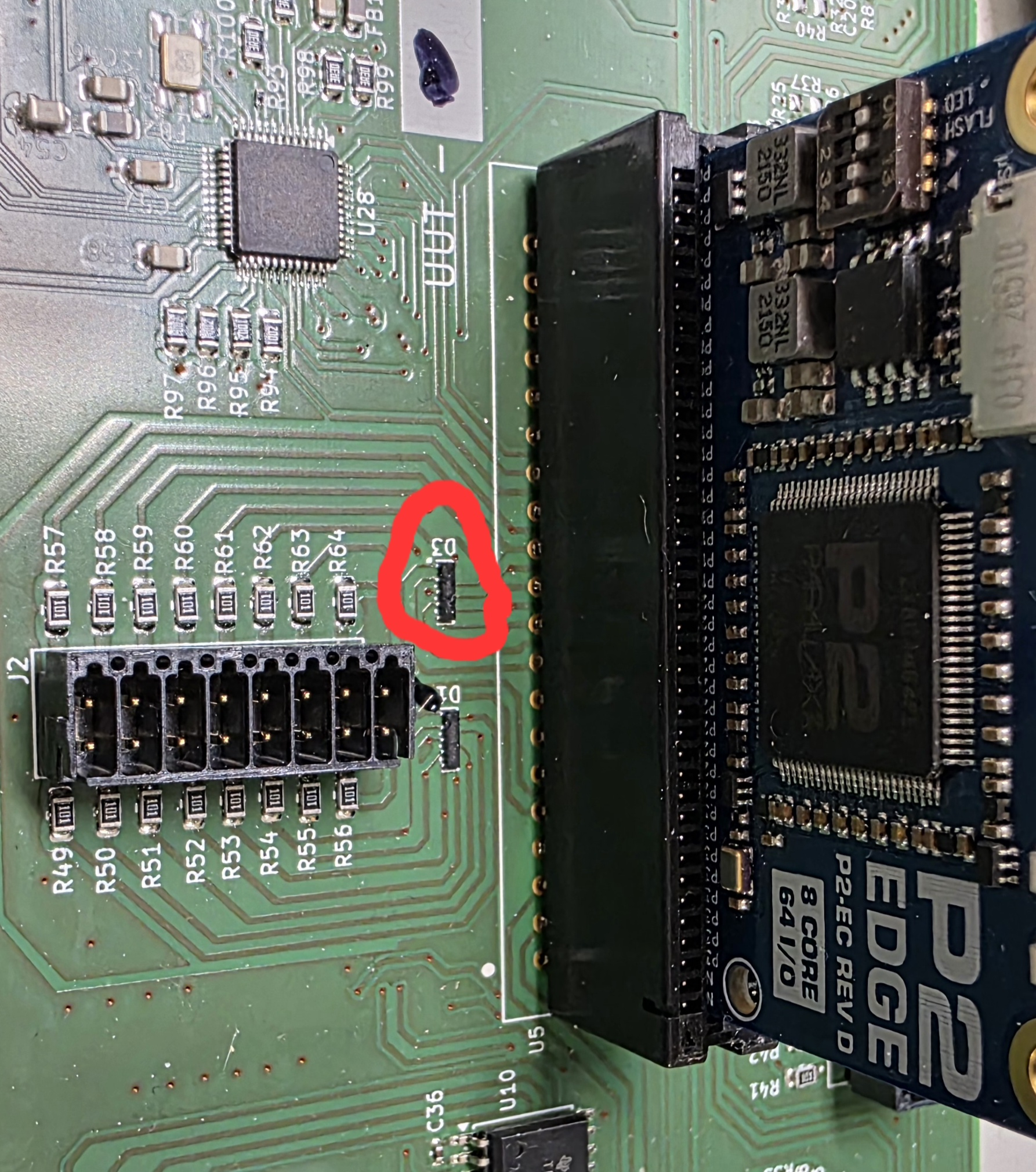

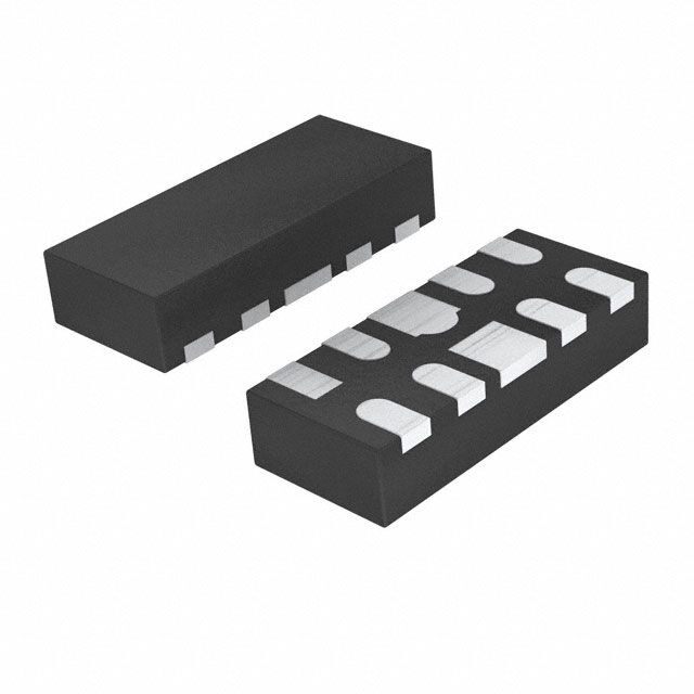

Think I'm liking these TVS arrays: https://www.digikey.com/en/products/detail/texas-instruments/TPD4E02B04QDQARQ1/7732454
It can just sit on top of four P2 I/O pin traces (as in the four that go to an RJ45 jack for external connection).
And, you have the choice of populating or not populating...
They are really good. Here is something very similar that does 8 pins. These packages get SOOO small. The 100 ohm resistors take a LOT of the edge off of high Dv/Dt stuff and _probably _would open up for something sustained.
