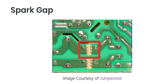

In a recent Parallax Online Forum, Chip Gracey showed a PCB spark gap, which was very interesting.
Never seen this before and am very interested... There can be some extreme events in my line of work with high voltage...
It was like the bottom one here:
https://atadiat.com/en/e-four-pcb-marks-part-2/
Another very interesting thing is the PCB fuse shown in the above link.
Think want to add both of these to next PLC type board where inputs come from wires to the outside (of cabinet) world...
Don't think the fuse is very controversial, although have never seen it used. Seems like a good idea though...
Seems there is some debate over the spark gap though. Guess the main thing is limited lifetime. So, this brings up the goal of using this and it is going to depend heavily on the particulars of the application...

    Yeah, I've seen both those before. Cheap AC-DC power supplies tend to have both. The fuse trick is for when the regulator blows up - making it a throw away.
    Spark gaps built like that aren't going to work on lightning strikes. You're designing for dealing with static discharges from clothing or maybe off the machinery. When the air gets dry, static becomes a real hassle.

  • Come on, those tricks are for dirt cheap power supplies, not for any serious equipment. The problem with the fuse trace is that it needs a much higher current to blow as would be good for the reliability of the board. The solder stop paint becomes brown and begins to smell funny at 2-3A for a 0.5mm trace. But it requires >30A to really blow. The voltage at which a spark gap begins to fire is heavily dependant on air humidity and dust contamination. When clean and dry a 1mm gap can take multiple kV without a spark. Wet and dirty it breaks down at a few 100V. And once it has fired carbon from burnt dust can accumulate degrading the breakdown voltage further. Even small tolerances from the etching process can have a large impact on the breakdown voltage. It matters if the copper edges are sharp or dull.
    So please use real fuses for overcurrent and real varistors or TVS diodes for overvoltage protection. They cost only 5 to 10cent. Not worth risking failures. And if they blow up they can be replaced.

    @ManAtWork I might be with you on this... Also thinking that TVS is going to be faster than air arc, so would go first...
    It's also strange that very few people mention these spark gaps and no actual companies seem to mention it at all (well, that might be because it's free).
    Still, seems like if it were a really good idea, there would be a lot more on the internet about it...
