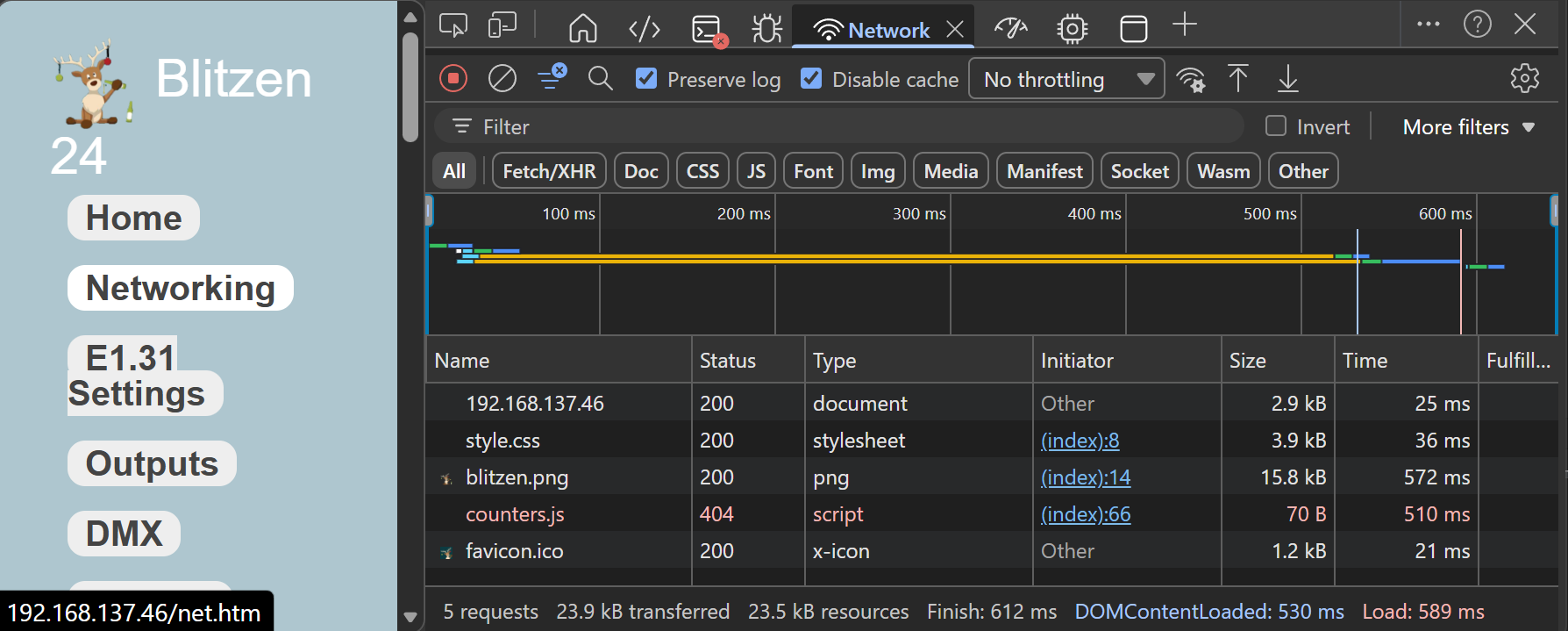

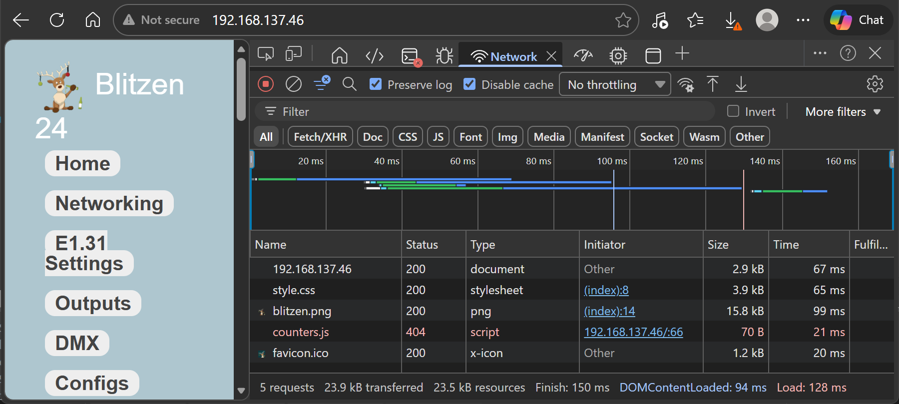

  • ke4pjwke4pjw Posts: 1,324
    I have not folded the MDNS changes into the SpinnerEdge 2 / W6300 code yet, however, I have incorporated the new SD object by @"Stephen Moraco" and used Claude to implement the taskswitching and structure features that @cgracey added to spin2.
    The combination of these features allows for robust performance of a webserver from a microcontroller.
    The new SD object allows for multiple files to be open and makes reference to them via a handle. The taskswitching allows for individual pseudo threads to be created to handle multiple http requests and switch between those tasks when an appropriate objective inside the code is achieved. The usage of structures makes this simple as any buffers and bookkeeping that need to be segregated for an individual task are placed in structures and indexed by the taskid. In other words, Task 2 knows where it's own in-buffer, out-buffer, maximum segment size, packet size, filename requested, etc are by referencing the structure with it's own taskid.
    This resulted in an almost 130% latency difference, where it would take about 600ms to load a webpage serially, that number dropped to 128ms when multiple requests could be serviced concurrently. This is expected behavior because during short requests via TCP, the 3way TCP handshake can be the most latent part of the exchange. Performing this simultaneously greatly reduces the latency. Additionally, up to three files can be downloaded at the same time whereas before, all other requests would have been blocking because only 1 TCP socket was assigned to service requests on port 80.
    Single Task
    Multi Task
