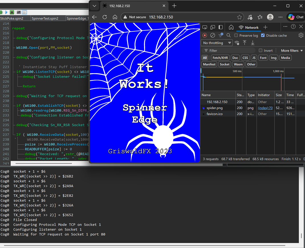

  • So far only changes in block selection. Web server works!
  • Congrats, Terry!

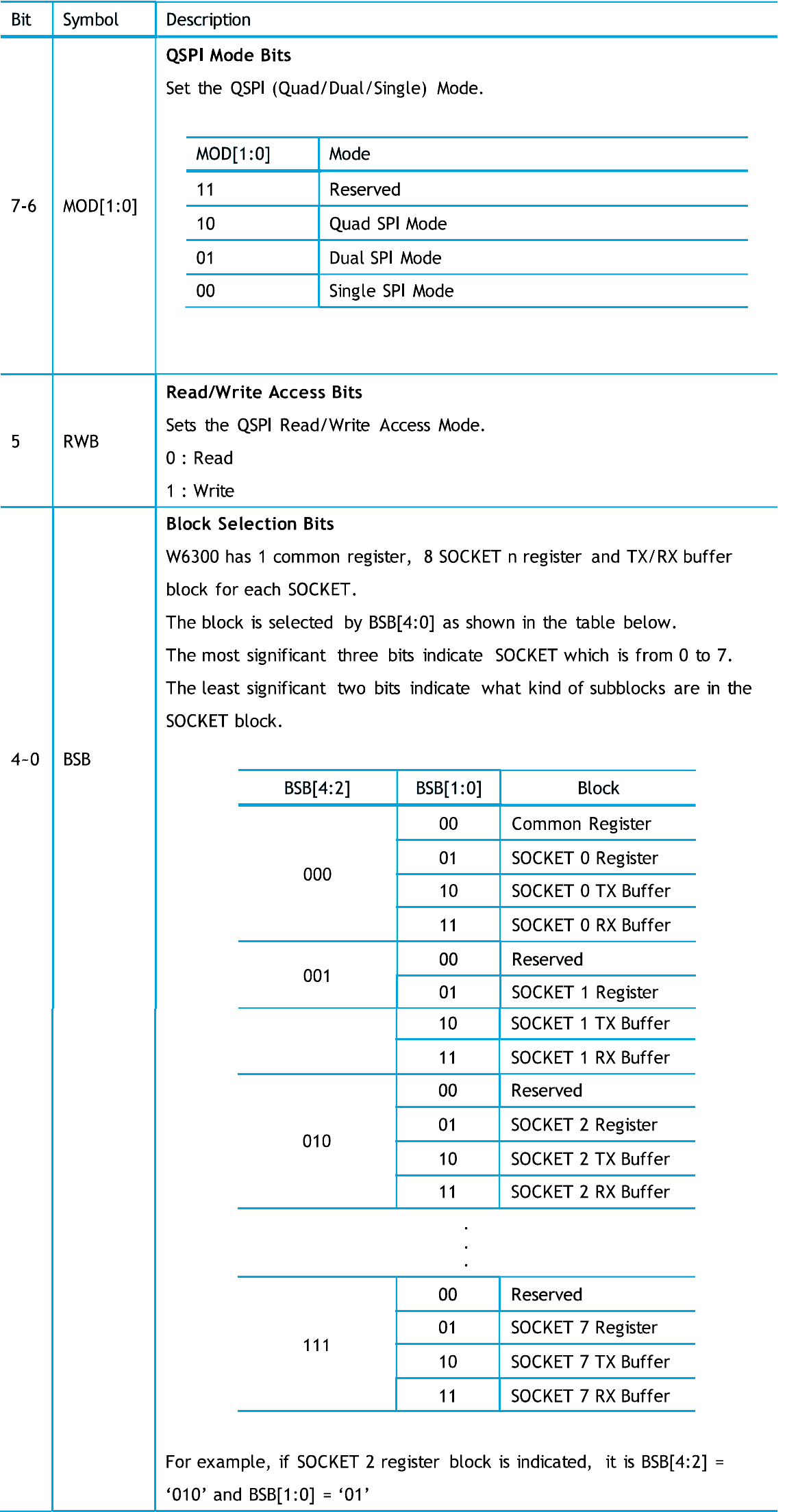

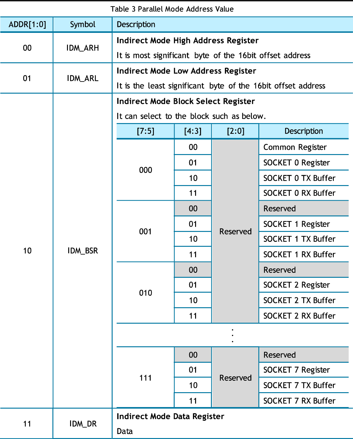

  • I wanted to capture the differences I have found between the W6100 and W6300. So far, the only issues I have found is the value difference of the SPI block selection. The parallel block select is the same between the chips, with reserved bits. Below are from the W6300 datasheet.
    SPI Block Selection
    Parallel Block Selection
    I had the extra 0:2 reserved bits in my constants and that was the issue that caught me here. I might be able to combine these drivers into a single WS6x00 driver. Not sure of the best way to go about it.

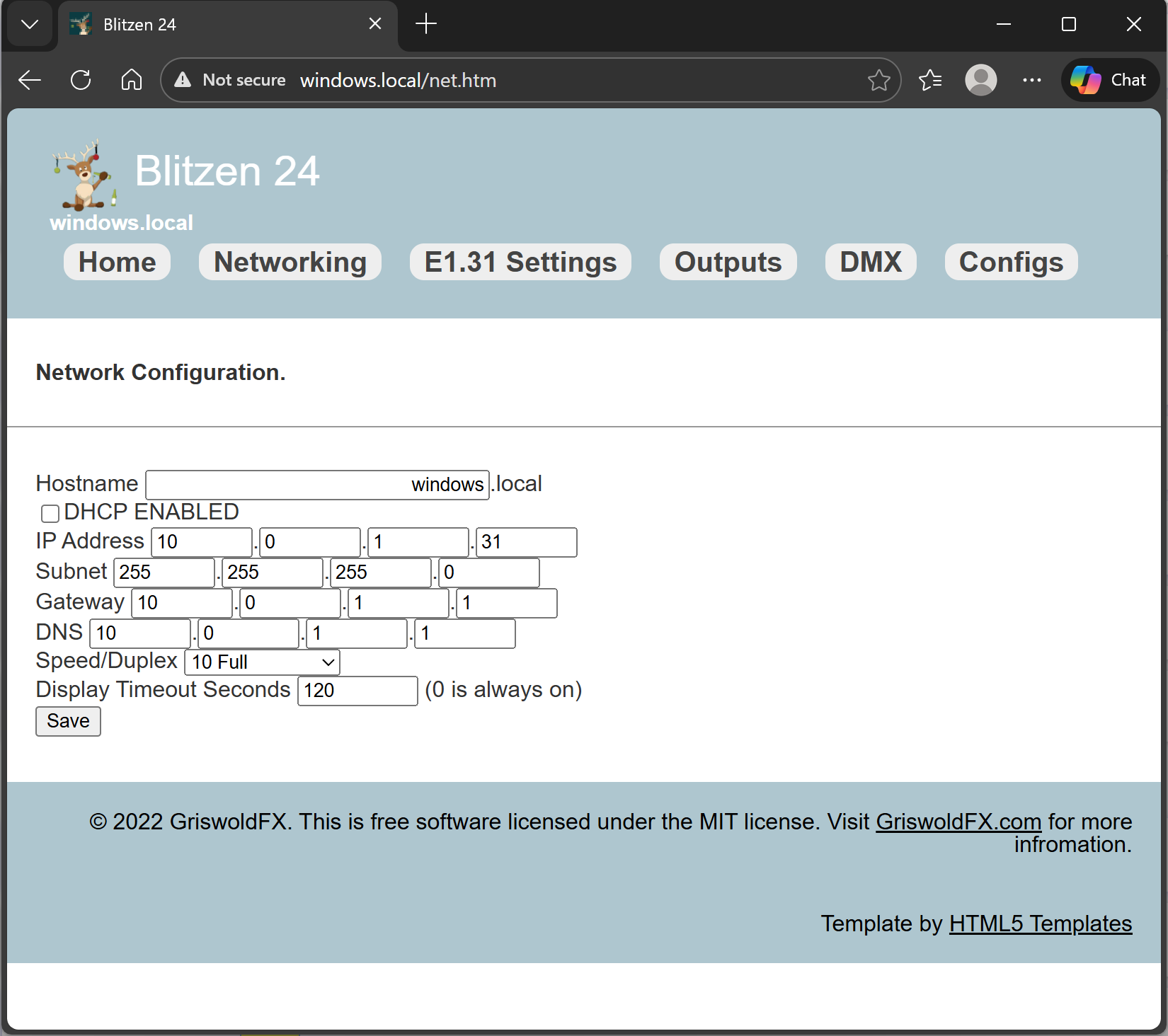

    New feature I will be rolling into the W6100 and W6300 example code base for the webserver: MDNS (Multicast DNS) It allows you to assign hostnames to network devices in the .local domain. Works with Windows 10/11, Apple devices, most Linux distros, but I am still having some issue with Android. It has a special case where the resolver expects a unicast packet in reply to the ephemeral port the multicast query was sent from. It works on Android, but not reliably.
  • RaymanRayman Posts: 16,460
    How does that work? Does the Wiznet ask the device for a preferred name?
    And then, everybody can address each other by name?
