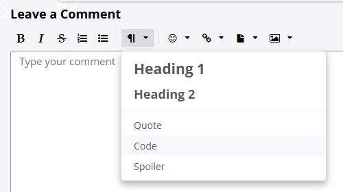

  • JonnyMacJonnyMac Posts: 9,787
    edited 2026-03-06 19:00
    It's easier for people to see your code when you use the formatting markers. I do it manually by putting three back-ticks (unshifted ~ key on American keyboards), but you can also paste you code into the post, drag-select all of it, and then click the formatting option from the forum post menu:
    This will preserve indenting which is very important in Spin and Spin2. With proper use of the code format markers your listing should look more like this:
