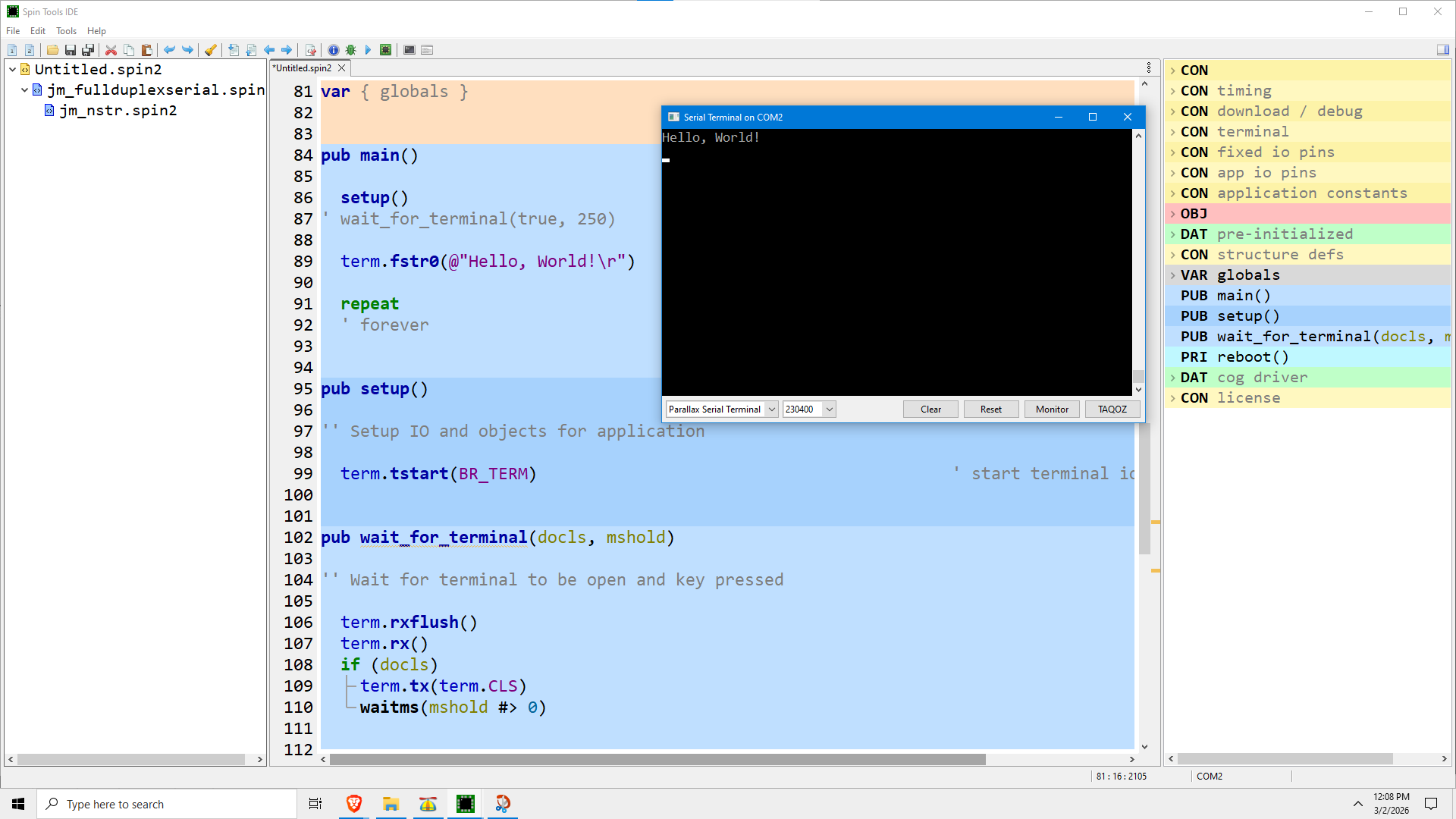

    My template program for the P2 is a "Hello, World!"
    Like the P1, the P2 needs a library to talk with a terminal. When the P2 first showed up I wrote an article for Nuts & Volts. While a lot has been added to Spin2 (which is updatable, unlike Spin1 that is etched in the P1 silicon), this article is still valid and will help you get a start.
    -- https://www.nutsvolts.com/magazine/article/an-introduction-to-the-parallax-propeller-2
    In my opinion, Spin2 is simpler and nicer than Spin1. I just spent a month updating an old P1 project that is almost 4000 lines in the main file; I constantly was wishing I had P2 syntax. That said, Spin Tools is a great choice of environment. Marco is very responsive to user inputs and serval suggestions I made while working on that big project made it into the current release, and are making my life easier.

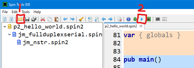

    Spin Tools is a very complex IDE. I was expecting a simple Load , Run commands.
    You're kidding, right?
    1 Open (Load) -- or use File / Open...
    2 Run -- or use Tools / Upload to RAM
    Maybe Spin Tools should have simple, easy to use version.
    It is easy now. And if I do say so, it takes a lot of nerve to ask for a "simpler" version of a program you haven't properly tried.

  • RaymanRayman Posts: 16,460
    No, that is for external tools...
    You want to use the icons below the menu, most everything is there...
    The blue play button is to upload to RAM and run.
    I usually do the bug icon which does the same, but with debug enabled...

    With your file open (File / Open... from the menu, or folder icon from the toolbar), press Shift+F10 (or Shift + blue Play button) to run a program that uses terminal output (like my template). Spin Tools has its own compiler (which is always running so you are show errors as they happen), but you may wish to use an external compiler like PNut of FlexProp -- the Run menu allows the use of external tools, but they do require setup.
    As Ray points out, there is a different toolbar icon for the P2 debug windows. For simple strings, P2 debug is easy. For more complex outputs, P2 debug commands can be tricky. You've been warned. In Spin Tools, basic debug information is output to a console pane under the bottom of the edit window. This debug output can also be logged to a file.

    Before you get going you have to tell the P2 how fast to run. CLK_FREQ is a [user defined] constant. _clkfreq is the directive that actually sets the P2 speed. In my template I create CLK_FREQ so that I don't have to read the system variable clkfreq, and so I can derive MS_001 and US_001 constants for waitct() used in synchronized delays.
    This is why I gave you a template to start with.

    In your template, the bit the novice is actually most interested in - i.e:
    pub main()
      setup()
    ' wait_for_terminal(true, 250)                                  ' needed for PST
      term.fstr0(@"Hello, World!\r")
      repeat
      ' forever
    is itself buried in the middle of a file containing over 100 lines of quite arcane code.
