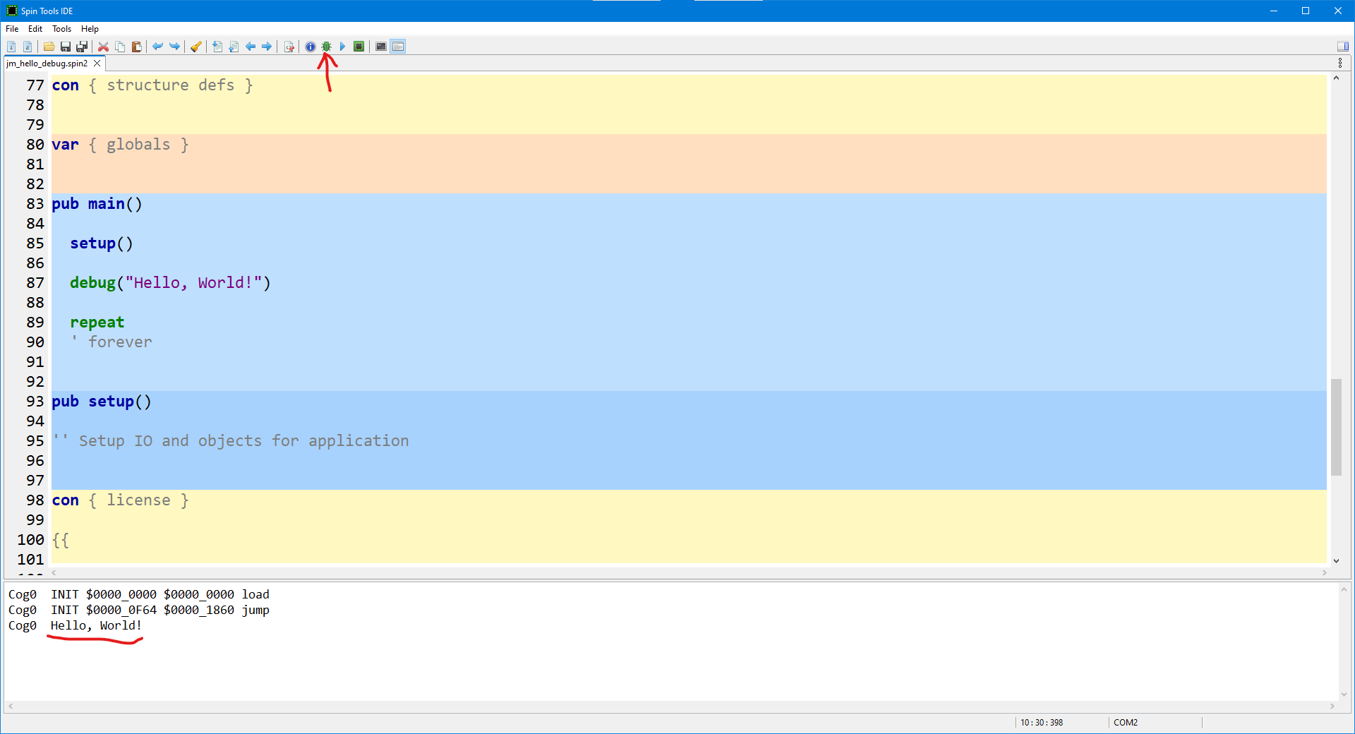

I loaded Jon's example program, and I assume that if you want to run the program you use thye run command. When I do the run, I get "No configured external tools", what is that and how do I get around that.
Ray
No, that is for external tools...
You want to use the icons below the menu, most everything is there...
The blue play button is to upload to RAM and run.
I usually do the bug icon which does the same, but with debug enabled...

repeat pintoggle(38) waitms(1000)With your file open (File / Open... from the menu, or folder icon from the toolbar), press Shift+F10 (or Shift + blue Play button) to run a program that uses terminal output (like my template). Spin Tools has its own compiler (which is always running so you are show errors as they happen), but you may wish to use an external compiler like PNut of FlexProp -- the Run menu allows the use of external tools, but they do require setup.
As Ray points out, there is a different toolbar icon for the P2 debug windows. For simple strings, P2 debug is easy. For more complex outputs, P2 debug commands can be tricky. You've been warned. In Spin Tools, basic debug information is output to a console pane under the bottom of the edit window. This debug output can also be logged to a file.

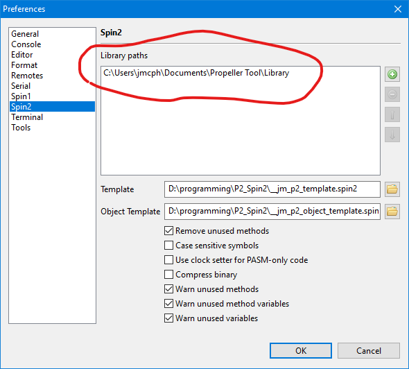

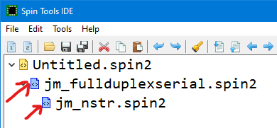

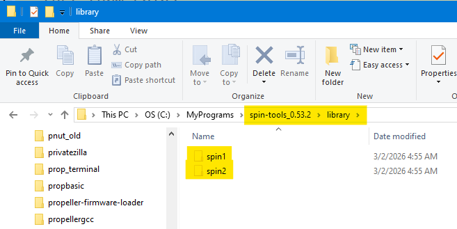

You probably don't have jm_fullduplexserial.spin2 in the P2 library. I don't use them, but Spin Tools defaults to libraries in its install location:
Move jm_fullduplexserial.spin2 and jm_nstr.spin2 to the P2 library folder and try again. You should see a blue icon next to the name in the Object Browser (if you have it open -- and this is a good reason on why).
The blue document icon tells you that the file is in a library folder; a yellow document icon tells you the file is in the project folder (these rules follow Propeller Tool).
If you want to customize your library location (I use the consolidated Propeller Tool library) you need to point to that folder in the Spin1 and Spin2 sections of the the Preferences dialog.

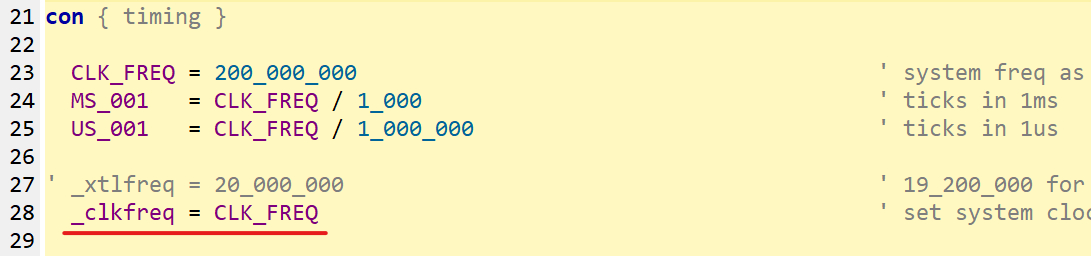

Before you get going you have to tell the P2 how fast to run. CLK_FREQ is a [user defined] constant. _clkfreq is the directive that actually sets the P2 speed. In my template I create CLK_FREQ so that I don't have to read the system variable clkfreq, and so I can derive MS_001 and US_001 constants for waitct() used in synchronized delays.
This is why I gave you a template to start with.
