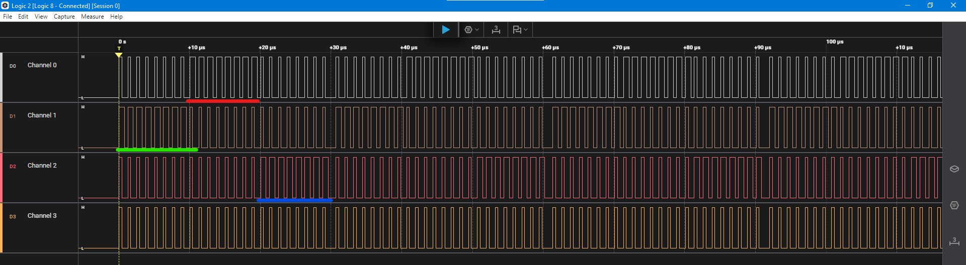

    Cool. I did one of those, too. I have the boards and the parts, I've just been too busy to populate and pop into the toaster over. Josh and I use a couple of 8x8 WS2812b arrays in one of our products and I thought this would give us something to use for experimenting with animation "cells." Again, not finished yet because it's a "nice to have" not a "must have" at the moment.
    Your board has more features than mine; I stuck to one pin and the pixels are powered from the 5v pin on the accessory header so I know I have to manage current. I wouldn't have considered trying the 2020 pixels in the past, but my friend Rick used them in the robot called "4" in the last Superman movie, so I decided to give it a try.
    1659 x 963 - 402K

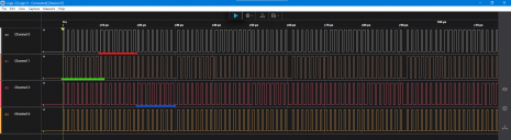

    I'll do you one better: a driver with 8 (contiguous) outputs that can all be independent. A couple of years ago Terry Trapp needed a multi-channel pixel driver so he and I both created versions. Mine is attached. This will give you more flexibility than writing the same data to every pin.
    The screenshot shows four channels so you can see that there is different data on every output.
