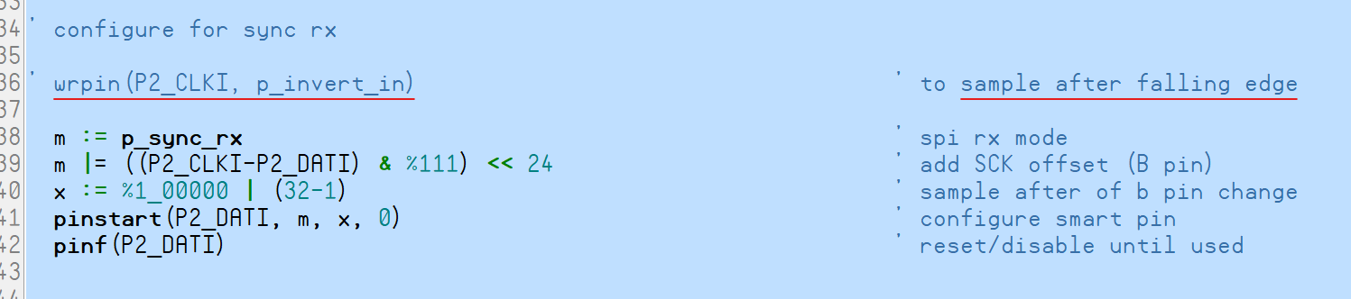

    Give this a try -- seems to work.
    In this demo I start up a background Spin2 cog and use smart pin sync_tx to simulate sending one 32-bit value (see screenshot from LA). used a set of jumpers on my Eval board to route signals.
    Note: the sync_rx function defaults to LSBFIRST so you may have to reverse your data bits before saving to the hub.

    polarity of the clock pin might be reversed
    or falling edge might be enabled
    see
    https://p2docs.github.io/pin.html#p-sync-rx

  • JonnyMacJonnyMac Posts: 9,809
    edited 2026-02-21 17:12
    dit: OK, my 70MHz scope is a bit slow for this, but data transition seems to start with falling edge.
    You may need to invert the clock input pin for the SYNC_RX. It's in the demo code, but I commented it out.

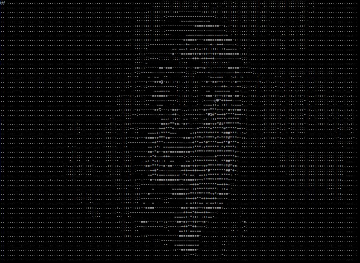

  • Thanks to Jon! Got first results.
    That's supposed to be me:
    I am using this "gated clock mode", so only 3V3, GND, D0, PCLKO, SDL, SCL needed.
    Cool!
  • AJLAJL Posts: 532
    Very nice :-)
