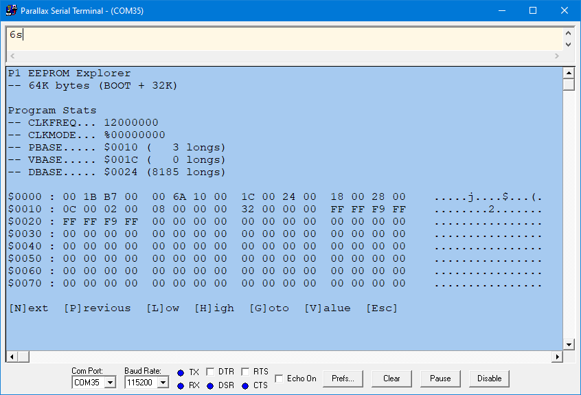

    The nice thing about being able to run from RAM is the opportunity to write a little program that dumps out the contents of the EE. I needed this for a gaming device that stores configuration in the upper 32K of the 64K EE (I always use 64K in my designs).
    Here's my little explorer program in the EE
    Moved code to this thread:
    -- https://forums.parallax.com/discussion/178021/p1-eeprom-explorer/
