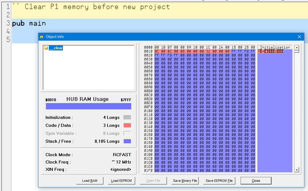

    Did you download your program with F11? That would put it into the EEPROM which will auto-load next time the P1 resets.
    I use this to wipe the P1 EEPROM. Yes, this is the entire program -- nothing else is needed.
    pub main
      repeat
        waitcnt(0)
    This needs to be downloaded with F11 for the EEPROM to be cleared. After that, running experiments with F10 will leave the EEPROM (and IO configuration) clear after subsequent resets.
    Here's the F8 memory map that shows that other than the harmless repeat loop, the EE is clear.

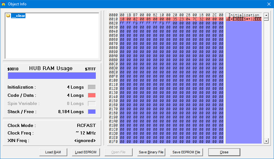

    Having an empty program works, too. I downloaded this to EEPROM and then tried to load another program to RAM. Everything was fine.
    Spin Tools and Propeller Tool produce the same output for blank program. The nice thing about Spin Tools is the built-in list file display
  • The reason the empty program works has to do with those mysterious F9 and FF bytes past the end of the program. These are the initial stack frame for the main method. When it returns, it returns to $FFF9 in ROM, which contains the bytecodes for cogstop(cogid)

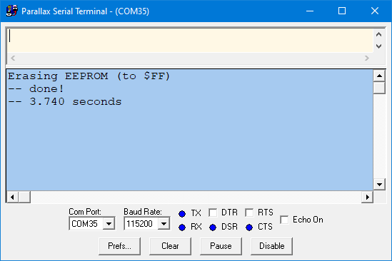

    A factory-fresh or erased EE is, yes (all $FF). Since the P1 loads the EE into RAM, it clears everything to $00 so that variables have no value when the program starts.
    The attached program "erases" the EEPROM. Most P1 devices from Parallax user the 64K EE so that's the object I used. When I run (from RAM) I get.
    This uses a PASM cog for I2C to make it as fast as possible. In this case, it erases the entire 64K EE on the FLiP in about 4 seconds (takes about 30 seconds with Spin I2C).
    I pressed the reset button on the board, then tried to download a new program. As expected, no problem. In our laser tag devices we sometimes run an erase on the upper EE to force the next version of the program to rebuild the non-volatile data space (that isn't modified during a P1 download to EE) -- I'm going through that now with a game piece.
